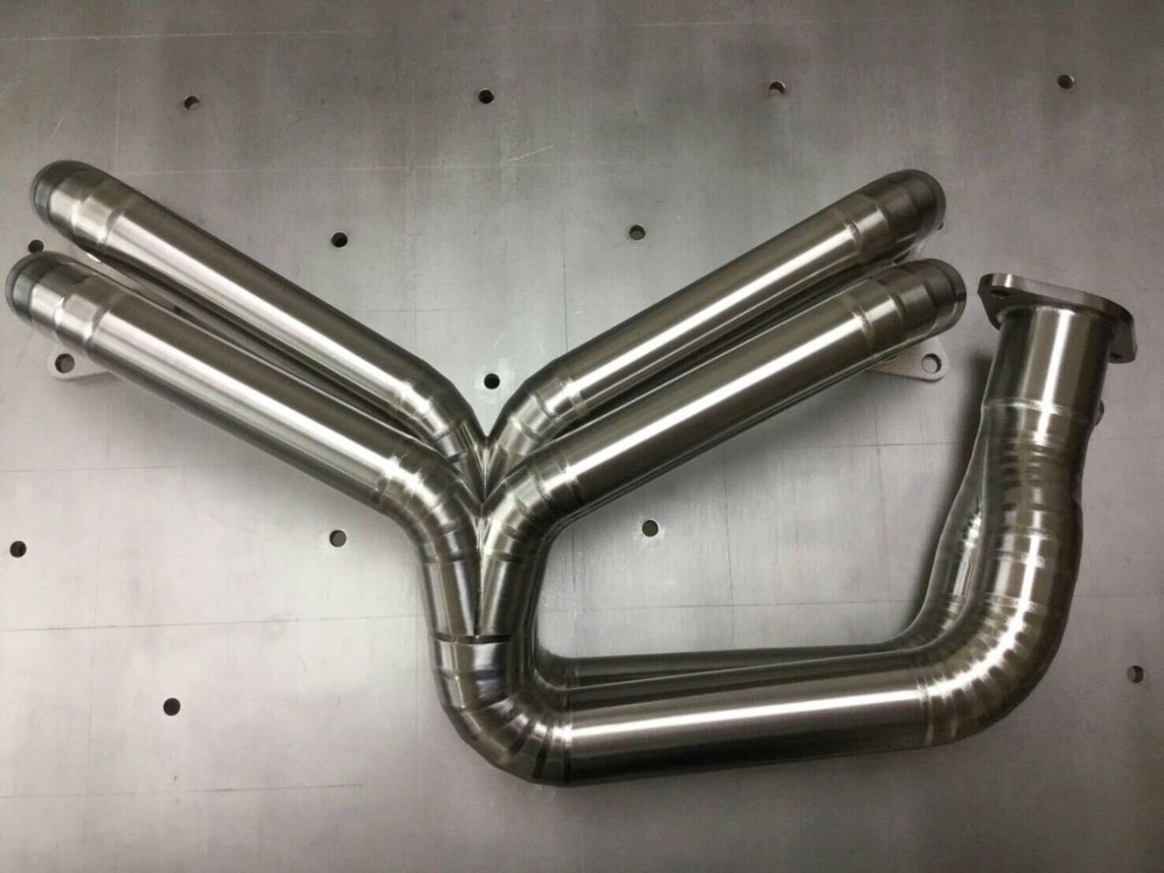

Posts: 4,334
Thanks: 696
Thanked 2,086 Times in 1,436 Posts
Mentioned: 53 Post(s)
Better add fan blowing on it
But yes, due mentioned by Mike points of bad thermal properties, not sure slight weight savings are worth probably extraorbitant price and probable cracking issues. They could have at least make it long tube 4-2-1 to make interesting contender with Ace / Nameless with more area under curve.

Wont be easy to do a shade tree weld repair on these.
Yep, it looks like something I would have made out of flex pipe, back in the 50s .......
(Sorry, manufacturer, I'm jest ah messen wich ya .....)

Is it really TI or just Ti coated?

We have one
It comes with a high price tag and zero warranty. TI is just too vulnerable to cracking and with the close quarters of the FT chassis it just isn't something we want to push mainstream. Also without bending the design isn't optimal to the types of gains we prefer on our cars.
We do have long term plans for inconel, but we're just not there yet.

Originally Posted by CSG Mike View Post
Extreme heat and vibration is the bane of Ti.
Titanium itself does very well in extreme heat.
It's a great insulator.
While Titanium is light and resistant to high temps it does not fatigue well. As @CSG_Mike said, it will crack. Guaranteed. The best materials for headers in order are 304 ss, 321 ss, and 625 inconel. Although the materials are priced accordingly. And because of that 304 ss headers are most common.
321 headers are considerably more expensive but because of the materials fatigue resistance at high temps you can get away with thinner wall tubing and therefore a lighter header. Where .065" is suitable for 304 you can get away with 0.049" wall with 321. And same goes for inconel. Inconel headers can be insanely thin and still resist cracking. Like 0.029" wall thickness! If you ever get the chance to pick up a set of indycar, F1, GTLM, etc. headers they feel like tin foil. It's crazy!
