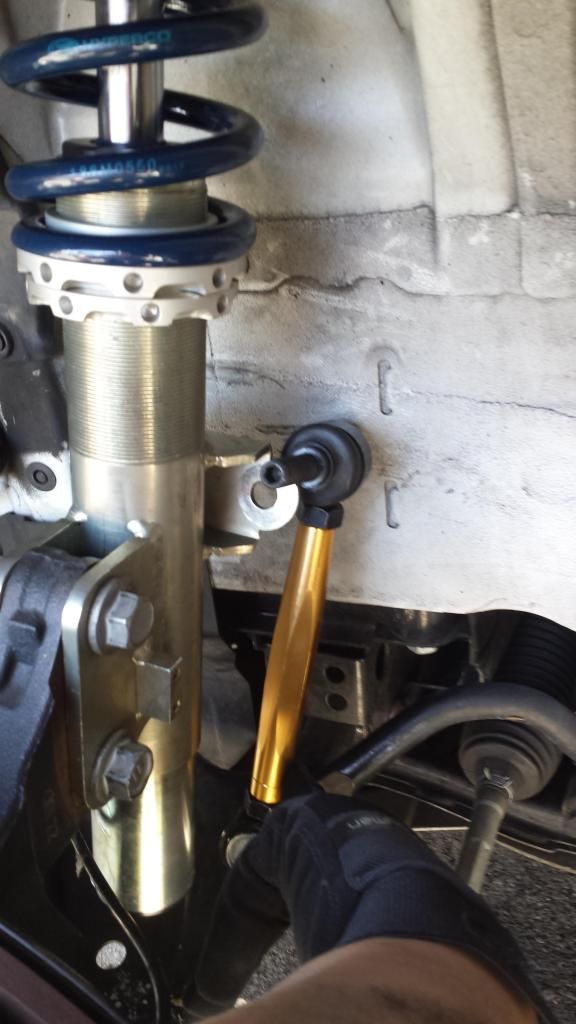

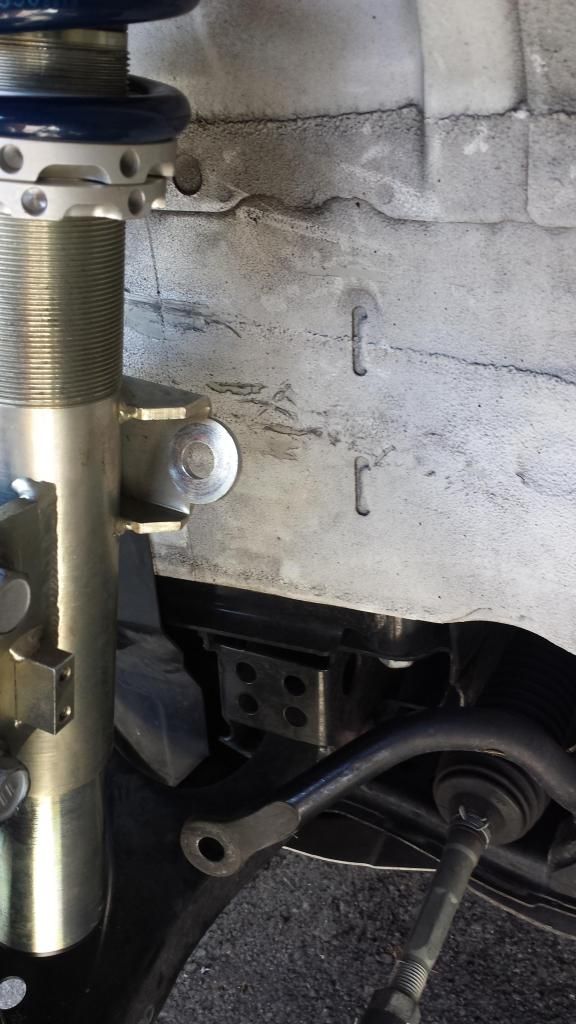

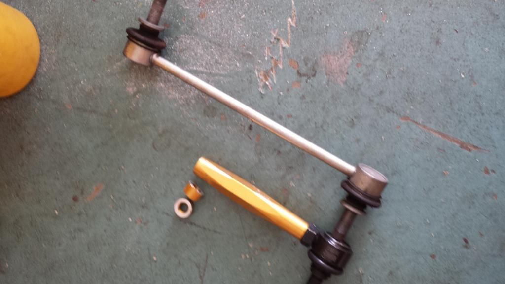

i knew it was the endlinks and here it is contacting the inner wells.
as you can see in the picture, the whiteline endlinks sit a tad higher
i went ahead and got a milwaukee saw and cut a decent portion off. whoever is considering hacking away at their endlinks should do so at their own risk. i'm not responsible for any injurys or deaths lol
took it for a test drive just earliar and now its fine!
