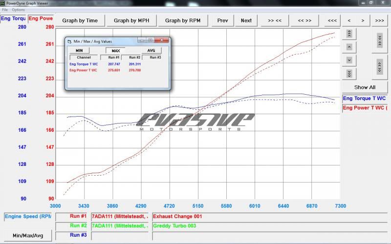

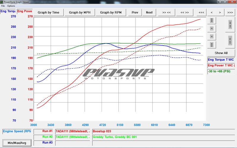

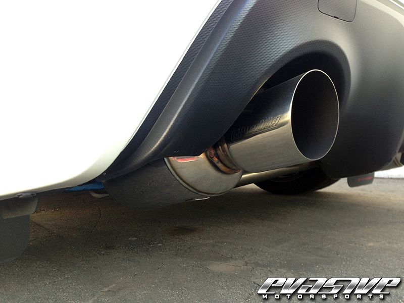

Midnight23 White on White Greddy Turbo Kit 275whp ***Evasive Tuned***
Finished our good friend and customer Jonathan aka @midnight23 clean BRZ. Just wanted to share this build for you guys to enjoy. The car made 275whp / 207tq on our Mustang dyno which is very impressive with a bolt on kit . The car is one of the higher numbers we hit on pump 91.
91 Pump Gas
275WHP (MUSTANG DYNO)
201TQ

GReddy Tuner Turbo Kit
GReddy Magnetic Oil Drain Plug
Invidia Q300 Ti Tips

Is that number at 7psi?
10-11psi
