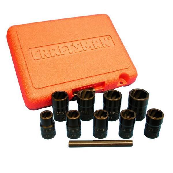

Bolt out/damaged bolt removers should do the trick if you’re ok with buying some new tools to add to your collection
https://m.sears.com/craftsman-10-pc-...SABEgJxa_D_BwE
