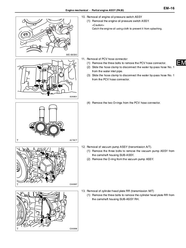

Take a look at the engine and see if it has the vacuum pump on the rear passenger side (Step 12 below). If it does it is an AR if not it was MT. The plumbing may be for an oil cooler. If so the nipple that you are concerned about may be unusual.
