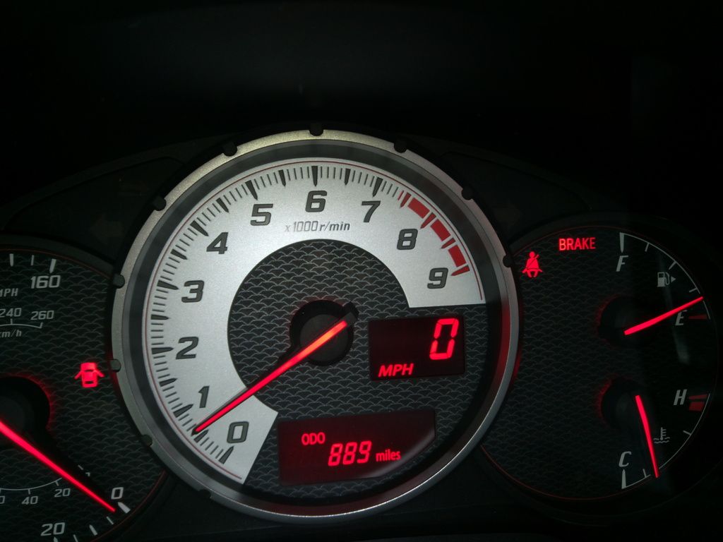

Look and see if you knocked the sending unit wire off while you where installing your intake.

What all have you done other than the intake? If measured hot it would look high you need to follow the instructions in the manual on how to check oil. Not likely to cause a low pressure light if just a little over full.
The 15s have very little history of oil issues.

Originally Posted by guybo View Post
Are you a complete moron? You bought the car 2 weeks ago, you get an oil light and you're doing ANYTHING EXCEPT tell the dealership to send a tow truck and haul off their problem? This is a joke right?
did you not read the light only comes on at 600 rpm and is flickering at 700 rpm. If I blip the throttle it goes away.
I will take the others advice and check to make sure something was not plugged in the morning.
Mate the oil pressure light is just a switch it come on at extremly low , virtully nil oil pressure something like 2psi or less.
Im rearly hoping its just a faulty sender.
Ring dealer imediatly , dont drive the car.
I wouldnt let on to the dealer you have been driving it for days with that issue as they could likely use that against you if their is any serious damage.
That light should never ever come on in normal operation of the car even at idle and efen at 500 rpm let alone at 600 or 700.

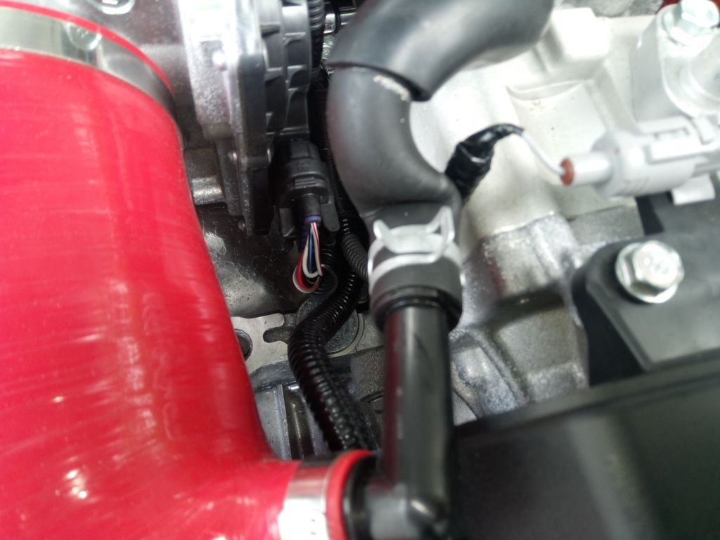

Solved!
thankfully I looked into this before overreacting and screaming at the dealership to come tow my lemon away but the error is mine.
Looks like this pinched vacuum line to the pcv valve? was most likely the culprit.
Also did what I said I was going to last night and reset the ecu. Added some dielectric grease to keep them rust free while the terminals were off.

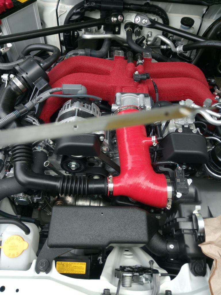

Also check the oil levels cold and hot.
Cold
Hot after settling 10 mins after.
Took it for a spirited run. Idle is right around 650 rpms with NO LIGHT!
SuperTom is offline   Reply With Quote
