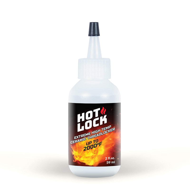

So I ordered some of the Vibra-tite mentioned earlier in this thread and have had two successful track days without issue since. That's hardly proof of anything yet, but hoping the stuff is doing it's job.
Originally Posted by PLX92 View Post
This is directed at the op, or anyone that has tired alternative solutions, has anyone had luck fixing these studs/nuts so that they do not work themselves out?
I found myself in the same predicament this past weekend, and this was after a pre-track check where I put a wrench on each of these nuts. Might just need to add a spare gasket kit to the track day tool kit.
Originally Posted by Lightened View Post
and then there is this stuff...
Vibra-TITE 19960 Hot-Lock Extreme High Temperature Ceramic Threadlocker
- Keeps assemblies from vibrating loose up to 2000°
- Great for muzzle brakes / recoil compensators, suppressors, vehicle exhaust bolts, turbocharger fasteners
- Water soluble for easy removal

I have also used the Hot-lock with success, but no track days on mine.

Actually ordered the hotlock, but still wasn't convinced I would be worry free long term.
