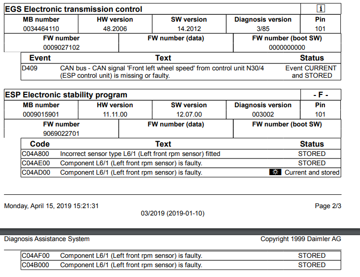

Have you moved it at all after the repair? Our VSS codes won't clear from ESP. Replace the part, still have a current fault As soon as it rolls and couple hundred feet the lights all go out, code is stored and can be cleared.
Other than short or open circuit there is no way for the module to monitor a speed sensor at a standstill. Until it rolls and starts reading that fault can remain current.

Originally Posted by Icecreamtruk View Post
Also, the reason I ask this is because elsewhere I read about this code, its always said that codes that turn your ABS light on do not clear with a normal scanner, seems to be the case for most other cars from a quick googling around. Also usually when I clear a code, even those that are still there, the code gets cleared, then it reappears again either after a few seconds, after a few miles of driving around or on next turn cycle. When I clear the codes for this one, it does not go away even for a second, light is solidly on, code still reading.
The code you can pull from an OBD II reader is a code in the engine module saying there is a code in the ABS module. You can not read the actual ABS fault with a normal generic scanner. Same with transmission, SCR and a handful of other modules.
With a more robust scanner you can read the actual ABS module and get the codes you actually need. That's why the engine code is so generic, it doesn't indicate any specific fault, just that there is a fault in the ABS system.
Oddly enough, there is usually an OBD II partition even in the engine module. You cna have a code on a real scanner and nothing on a generic scanner, or a CEL on, no codes at all on the $40k+ scanner, $20 walmart scanner pulls it right up.
Emissions is a funny game.

This is one I had yesterday. ABS/ESP lamps on, no CEL. No limp mode.
Current event in the transmission module, which could set a check engine lamp but did not in this case. Often you will have a code in the engine module for implausible CAN message received as well. The actual fault codes are in the ESP module.
Without a real scanner you aren't getting this far. Some of our cars have 90+ control units. The vans are in the high 20s, low 30s.
On this one, I replaced the LF wheel speed sensor. All lights still on, current faults. Lights were gone before I left the parking lot, codes were then stored and could be cleared. 5 different codes for a bad sensor, 4 with the exact same title. Silly Germans.
