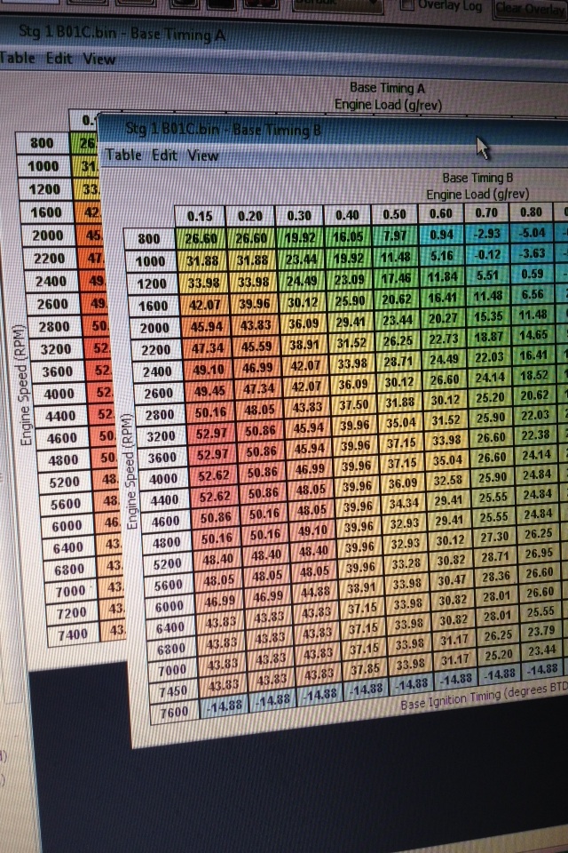

ie take 100rpm off those 4 values. should do it.
So it looks like Base Timing A is set at 7400..should I lower it to 7350 or 7300? Lowered Base Timing B to 7500.

Originally Posted by JB86'd View Post
Attachment 87037
no need to touch the BASE TIMING A it only used for limp home mode I believe :-)

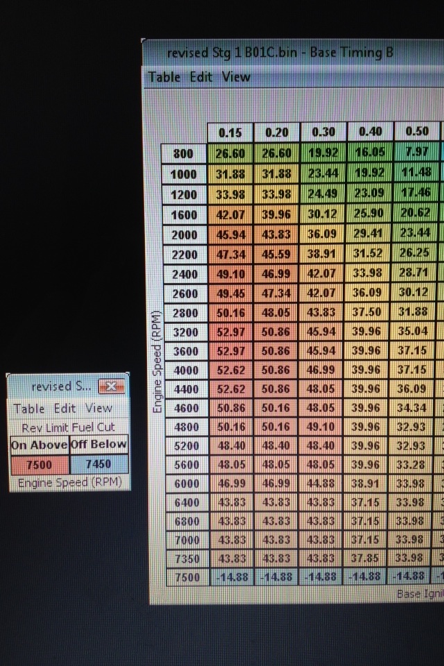

Totally misunderstood you @steve99 I think I've got it now! Thanks for your knowledge and help
Attachment 87044
No worries mate, looks sorted now
