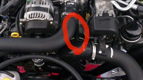

Ok
How about the vacuum hose that connected on the stock intake tube, it says I'm suppose to take it off completely I believe, or do I connect it on the avo intake tube that is connected to the air box? If not, what is suppose to be connected to that side of the inlet tube

Old 04-10-2014, 02:52 PM   #74
protpibe
protpibe's Avatar
Drives: 4-Runner Sport - 13' BRZ SportTech
Location: Winnipeg
Posts: 1,395
Thanks: 253
Thanked 839 Times in 459 Posts
That's not a vacuum hose, it's a cramk case breather line if it's the one I think you're thinking of. It connects into the AVO intake line just after the airbox if that's the case.

Old 04-10-2014, 03:31 PM   #75
Astroboy
Astroboy's Avatar
Drives: None
Location: Tx
Posts: 1,271
Thanks: 1,269
Thanked 142 Times in 122 Posts
Take a pic and post it to be sure.
Here, it is.

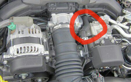

Old 04-10-2014, 03:35 PM   #76
Astroboy
Astroboy's Avatar
Drives: None
Location: Tx
Posts: 1,271
Thanks: 1,269
And my other question is what do I do with this hose. I think the manual says to take it completely out, but what am I going to do with the end that connects to the engine?Name:  uploadfromtaptalk1397158524720.jpg
Sent from my LG-D800 using Tapatalk

SkAsphalt
Ridge Racerrrrrrrrr
SkAsphalt's Avatar
Location: Regina, Sk
Posts: 3,516
Thanks: 5,786
Mentioned: 37 Post(s)
Originally Posted by Astroboy View Post
And my other question is what do I do with this hose. I think the manual says to take it completely out, but what am I going to do with the end that connects to the engine?Attachment 73996
That is the line that you plug into the fitting coming out of the intake pipe that points toward the throttle body.
Protpibe taught me that one

Old 04-10-2014, 03:39 PM   #78
protpibe
protpibe's Avatar
Location: Winnipeg
Posts: 1,395
Thanks: 253
Good thing you posted those pics because the hose you posted is the one that plugs into the intake tract. If you meant the 3/8" hose coming off the oil reservoir, then yeah, that one also plugs into the intake tract pre-turbo. You'll need to use a tee fitting to splice them all together.
