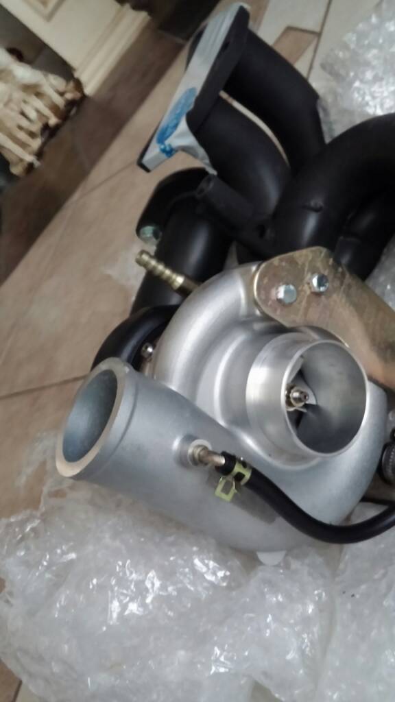

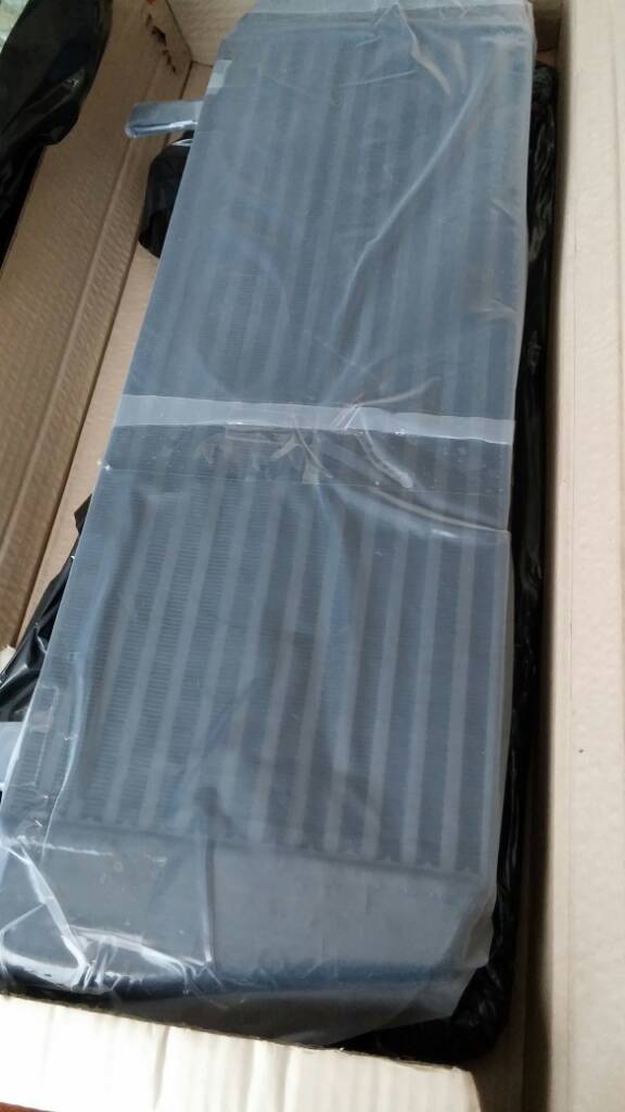

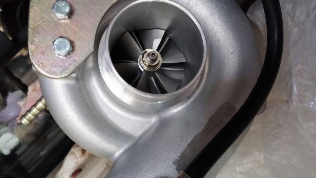

Size:  46.2 KBName:  uploadfromtaptalk1396561663748.jpg
Size:  48.7 KBName:  uploadfromtaptalk1396561687408.jpg
Sent from my LG-D800 using Tapatalk

Nice!
The one T-Bolt clamp I haven't replaced yet is the one on the Turbo inlet (PIC 2). Can you do me a giant favor and measure the diameter? The only thing I can offer is a "thanks" on your post lol

Originally Posted by protpibe View Post
Nice!
Yea I'll get the measurements, give me some time ok
