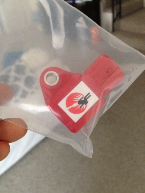

Kraftwerks told me the reason why the new tune they sent me didn't idle was because I didn't have the right MAP sensor so they sent me this nice new red MAP sensor. It got to me the next day and just installed it with the new "factory" Skunk2 tune file they had previously sent.
I'm happy to say that it drives a lot smoother around town in the short test drive I took. Looking forward to see how it performs at WOT later on tonight. Very happy with how Kwaftwerks responded to my input here even though it took a little time. Name:  ImageUploadedByTapatalk1396045407.956429.jpg
I'm happy to say that it drives a lot smoother around town in the short test drive I took. Looking forward to see how it performs at WOT later on tonight. Very happy with how Kwaftwerks responded to my input here even though it took a little time. Attachment 72252
Whats the difference with this map sensor? I may have missed it but what makes you need this map sensor over the one they sent.
