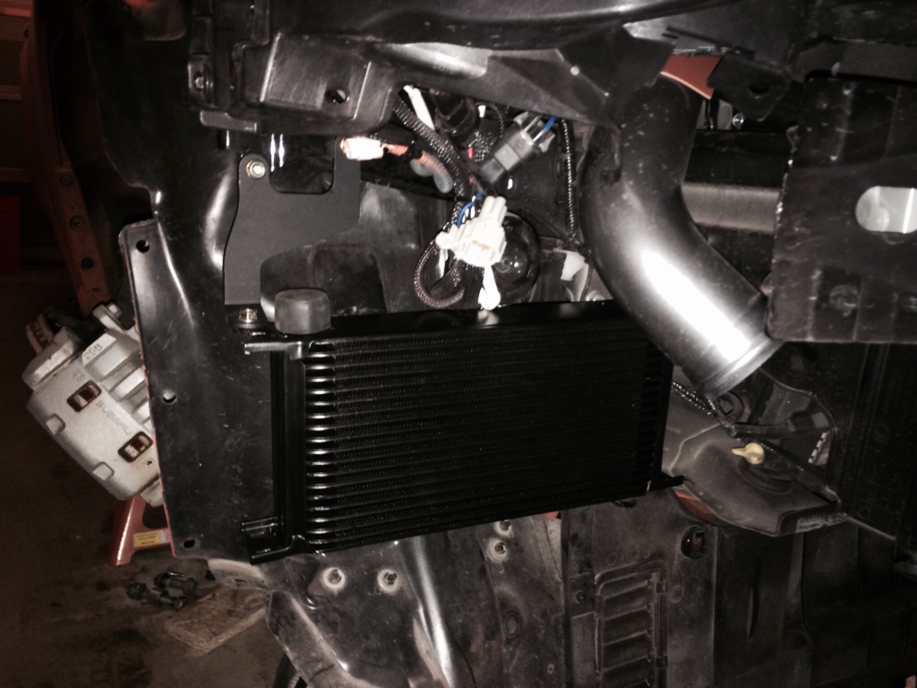

So without directions I took out the IC thinking the oil cooler would go behind it but nope, it's behind the parking lights. Good news for me since the APR bumper ducts will blow air right at it.

Not done yet. Lines are a tight fit at the cooler.

So... how much airflow is there in that location? Do they have you cut the fender liner?

I didn't receive instructions Mike. I'm just winging it. I noticed their car had liners removed in earlier pictures and I think that's the intent with this location. They mentioned there would be 2 mounting locations available, 1 behind p lights and the other behind IC. I only received brackets for the p light location.
This is a pre-production kit so it's still being refined with input from people like Omar and myself. This location will work well for me with my APR bumper that isn't utilizing the duct hoses.
