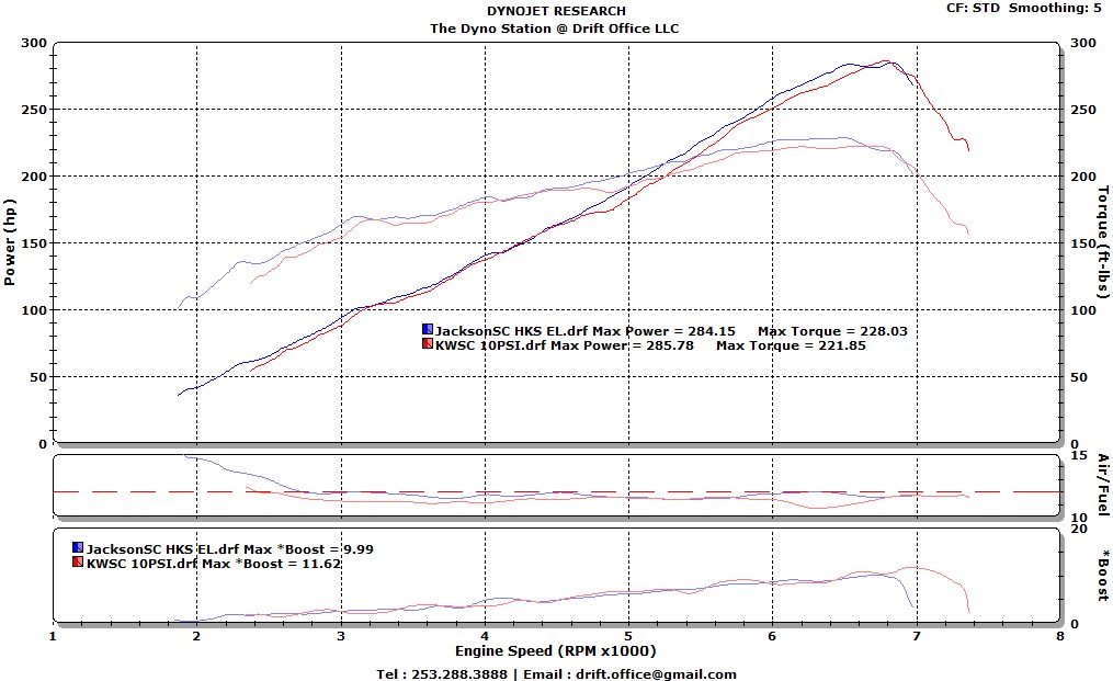

Originally Posted by Ocho Seis View Post
RE dynoed car March 15 boost lost now seen AT 6 RPM 1.5 POUNDS of boost lost.
Not sure what the hoopla is all about - anyone got a dyno run with a boost plot to see what you're talking about?
Here's mine with both the JRSC and KWSC - no issues in boost whatsoever.
Name:  kwsc vs jrsc.jpg
Regards,
Bob @ Drift-Office, LLC
Drift-Office is offline   Reply With Quote

Here is the the new dyno with the dip , my first dyno as well let me know if you have any ideas.
I contacted KW they said they had the same issue with there BRZ.
System was full checked for leaks and any other issues , system is leak free ...
Attachment 71812
Regards,
Ocho Seis is offline   Reply With Quote

sorry heres the first dyno as u can see no issues , so something is going on

I would say belt slip at higher RPMS causing less boost... but there is no way the KW setup can have belt slip can it? I thought the pulleys were cogged?
