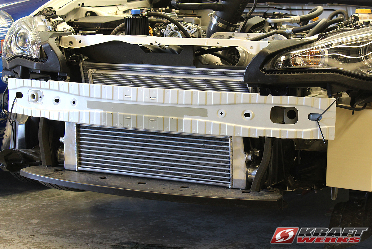

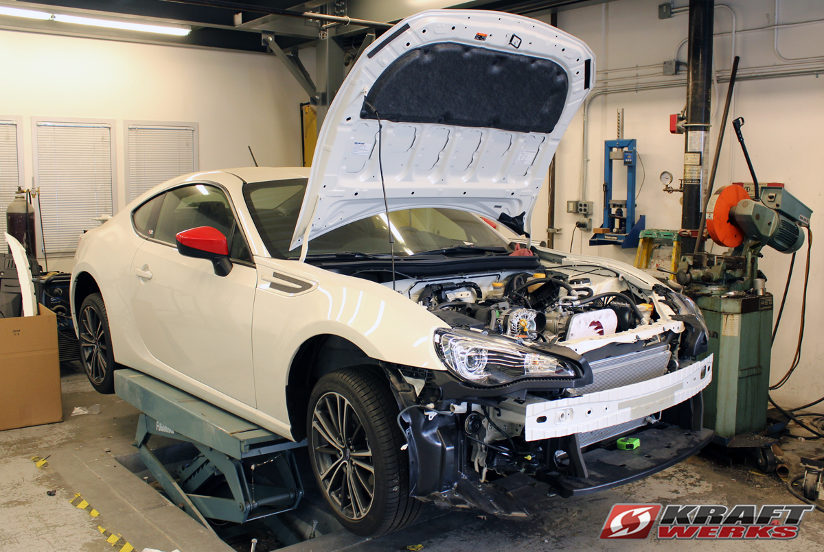

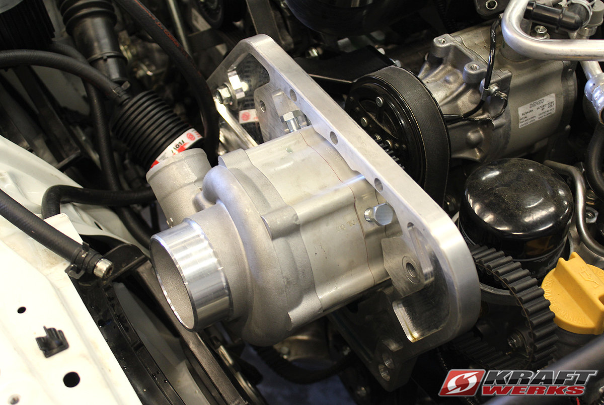

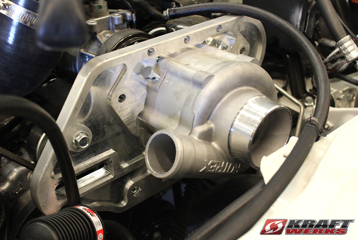

Showing their build of a rotrex based supercharger setup for the 86 platform.
I would assume this will come out very simliar to the litchfield setup. However they show a mounting plate that is shifted off center to the driver side which would allow a cold pipe to be on the passenger side instead of over the oil filter like the litchfield setup (which is really odd!)
Litchfield placement:
Kraftwerks placement:
Hopefully this comes out nicely. Their honda kits have shown decent numbers in the past. Maybe we can get them to start posting updates on ft86club as well on their progress! I'll send them an email and see if they can get more info.

It looks like they're using a second belt instead of just a longer one.
Possible pros, more packaging flexibility.
Possible cons, more rotational mass.
Just an observation. This is probably a good thing, especially looking through the hole above the rad. The intake pipe couldn't be any straighter.
