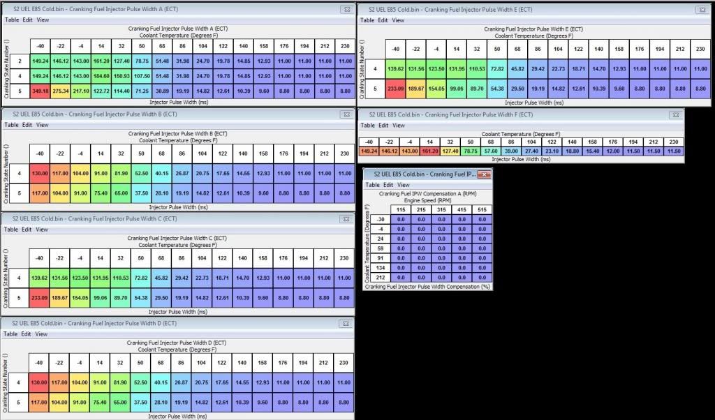

Shiv, the changes you made to the cranking tables are insufficient for temps below 30. 40+ cranking attempts this morning and I'm still stuck at work with no way to adjust the tables since I don't have a laptop and my computer is at home. Looks like if I can actually get this thing started I'm going back to the changes I made... at least they would get me started in 5 or less attempts.

This will largely be fixed once more than two maps can be loaded onto the OFT at the same time. I have the E85 map I'm using plus a normal Stage 2 map loaded just incase I have to take a trip somewhere and there is no E85 available. I knew I wasn't going anywhere yesterday or this morning other than work and then home so I guess I could of put my previously known working E85 map on there instead of the normal stage 2. With the ability to load 5 maps I could of loaded the new beta map and tested it when it was cold without fear of being stranded. Regardless I got it cranked finally after 45 minutes of trying.
Here's a data log of a couple attempts to get cranked for those that are curious. Not sure how helpful they will be. http://www.datazap.me/u/malt/cold-st...-12-16-13?1-11
Disclosure, I make no claims as my abilities of tuning a car or even adjusting tables in these maps. These changes were the result of discussions with much more knowledgeable people than me. They were not my idea so don't give me credit.
For those of you that are potentially having cold start issues like me, here is a copy of the tables I've used with success. It starts on the first try 80% of the time and on the 2nd attempt 99% of the time. These changes have worked for me for temps down to 21 degrees. Below that I have no clue and make no claims to its ability to work.
Essentially its the tables used on the 1.40 E85 maps but with the 68 degree columns multiplied by 1.2, the 50 degree columns multiplied by 1.25 and everything below that multiplied by 1.3
The Fuel IPW Compensation A tables are zero'd out.

I'm still not sure what the issue is with cold starting and shiv's maps and why my car needs so much more fuel than his to crank. Could be I've got more ethanol in my tank than he does? During the process of trying to adjust my IPW tables I received a link to an article about flex fuel vehicles and how their injectors have heated tips and their intakes have heating elements to help alleviate the cold starting issues.
I've considered adding a gallon of 93 to the tank before I fill up next time based on some of the results I've seen with some peoples LTFT's and cold starting but I should probably test the amount of ethanol before I actually go through with this. Its not that I'm concerned with my LTFT's but the cold starting issues are annoying to say the least.
