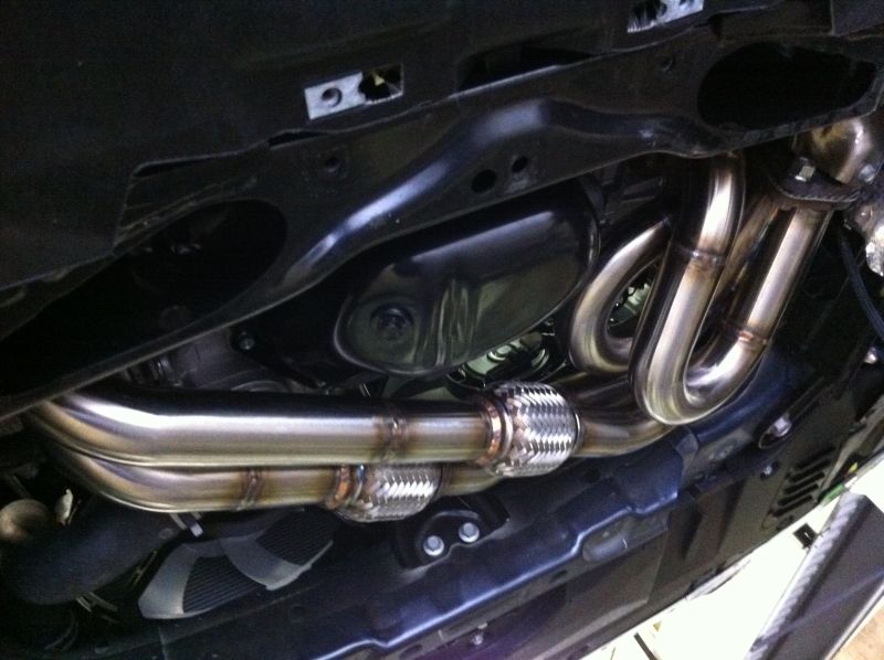

Did those bolts need to be changed because of clearance problems with the stock overpipe heat shield?

Quick question, does this header get in the way of any components in the engine bay,and are you able to use the OEM splash guard with it? Otherwise Im very impressed.
JDL took the header back to the jig and adjusted it because the few initial ones rattled against the guard. It is no longer happening and the flex braid sections do not rattle or crack either.

Originally Posted by Drift-Office View Post
^^^ I just changed the bolts in this last picture and it was all gravy...
Bob @ Drift-Office, LLC
Did you swap out the bolt, or just put a washer on it? Mine were like that too...and I was a little concerned but didn't really feel anything when checking for leaks.
See OP :
Installation was pretty straight forward - other than making sure you're on a lift to do it properly, there weren't any issues... until we started up. The supplied bolts weren't cutting it and a small exhaust leak resulted where the header flange met with the stock overpipe. No biggie. Went to the bolt bin, sourced out another 2 smaller ones and the issue was rectified in minutes.
