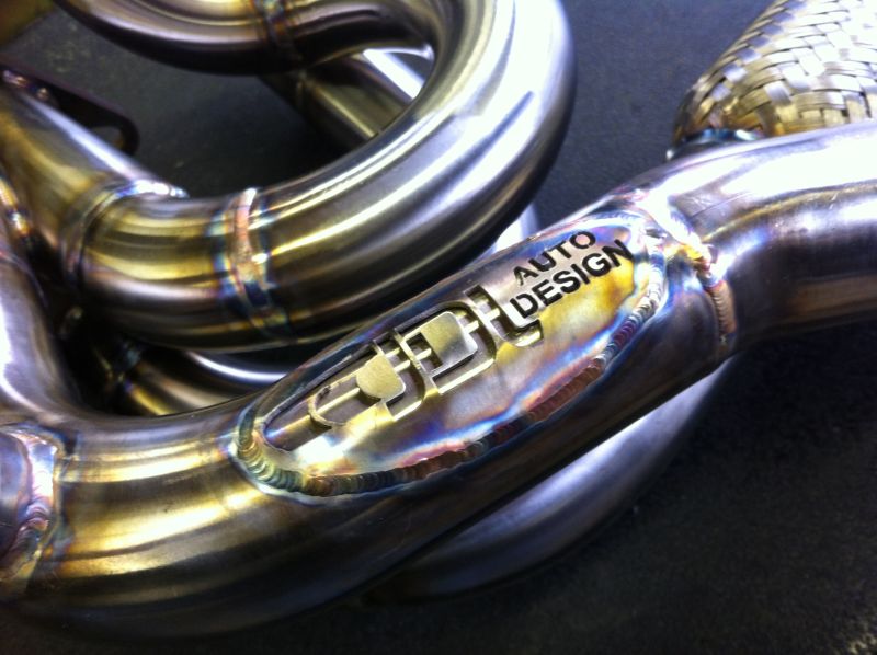

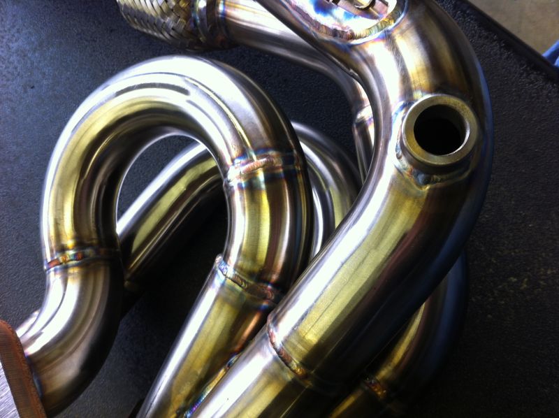

Top notch quality and construction, attention to detail and a clean finish makes the JDL a popular choice, and rightfully so.

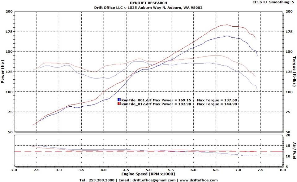

Results : Rather than posting a bunch of baselines and such, I'll cut to the chase and post up the before and after results. Here they are...
Attachment 55314
^^^ 4th Gear Pull : Alleviates (not eliminate) the torque dip from 3200RPM but gives you the top end to red line! Almost 190WHP and 150#s TQ! To date, this has been the highest performing UEL that we've tested (between Borla / RevWorks) and all this on a STOCK exhaust system too!

Without having to sound like I'm gushing, I think I speak for all the peeps that were here today to witness the event that this is certainly one exciting product and out performed our expections. Oddly enough, I had mentioned to the customer before tuning that I had expected the performance to land between the BORLA UEL and HKS EL offering and I was right! All this on a stock exhaust system too!
For those concerned with the wait, fret not for this is the choice that gives you not the best of both worlds, but is the only offering that gives you the Suby rumble people look for in a UEL and better top end than the average UEL and falls slightly below the performance of a EL...
