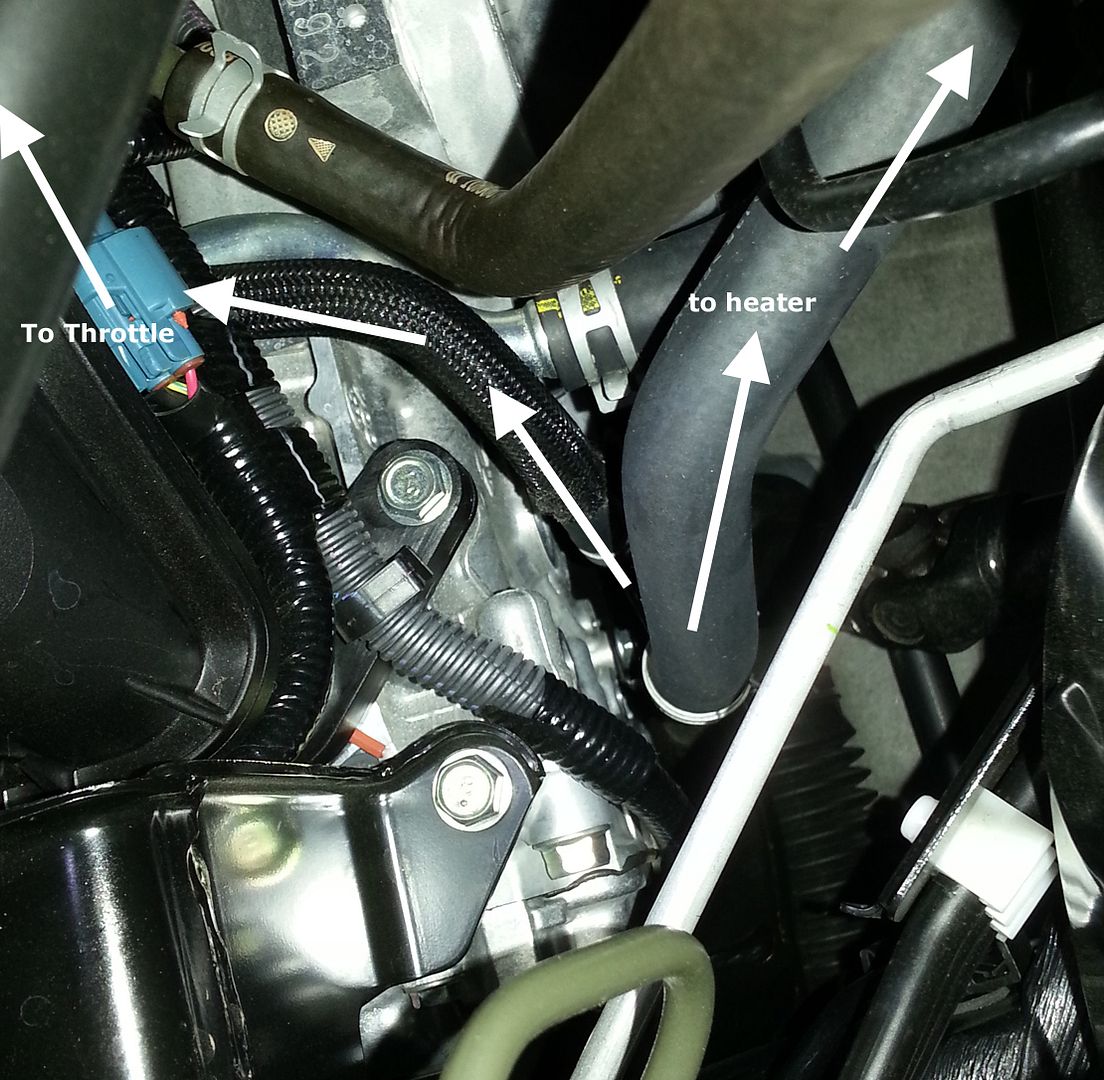

I just spent a few minutes staring at the coolant lines on top of the engine...
The inlet coolant on the throttle comes from the heater hose, and the outlet goes into the crossover pipe. It might be good to splice it from the heater hose pipe side, but I'm not sure the piping is large enough... Its pretty small, I need measurements!

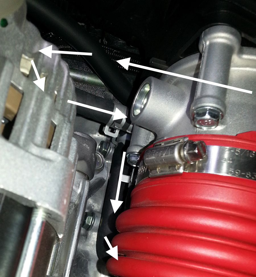

Ok, here is the throttle and the coolant flow in general...

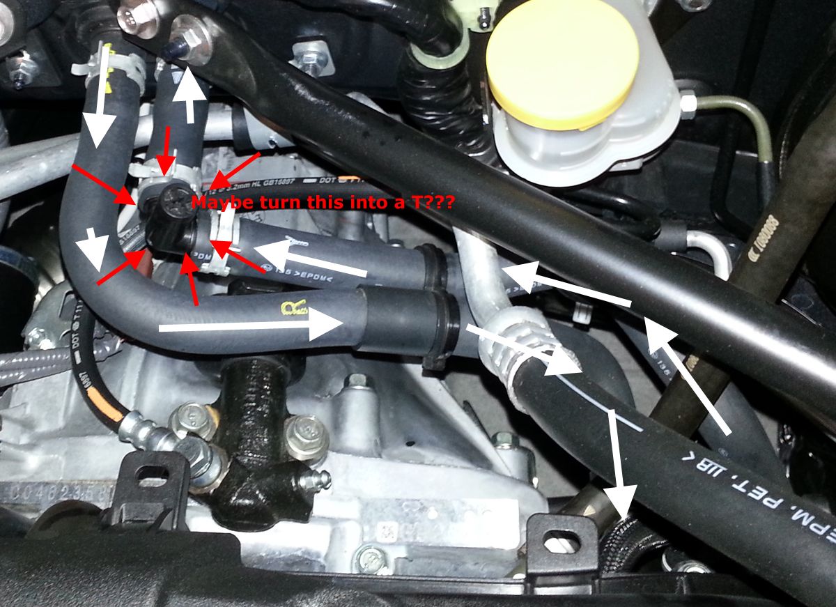

This was something else I saw that might be possible, turn this elbow into a T fitting and use that to send coolant to the cooler or as a feed back into the cooler if it comes from somewhere closer to the water pump.
