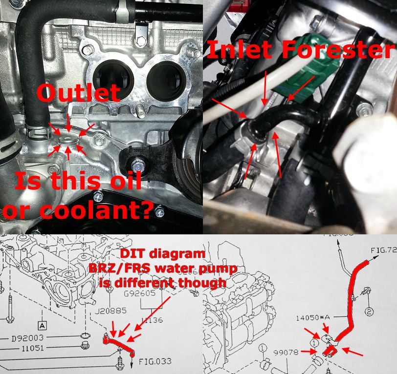

Anyway, some diagrams...
DIT coolant diagrams:
BRZ Coolant Diagrams:
This is what I'm thinking:
This is awesome stuff, nothing worse than an air to liquid oil cooler on a street car. The Subaru engineers chose this method because it makes most sense.
However I don't think your proposed coolant flow will work well because there isn't a pressure gradiant, you have to force the coolant thru the cooler because its a constriction. With your proposal you would want to eliminate the elbow instead of bypassing it.
I just assumed that was what he meant with the diagram. In any case, this would be much better than an air/oil cooler for street cars. Oil operating temp would be maintained much better with this (or the Robispec).

Ok, my second idea for piping... This is an attempt to route it like the actual DIT is routed. I'm just not sure if the BRZ has the correct coolant port for attaching a fitting to in order to have it outlet coolant for the cooler.
The inlet pipe is just the Forester one, which I'm not sure how expensive it is but probably not much.
The original Cusco kit uses a fitting on the back of the water crossover pipe thats actually a useful spot for MT cars, but I'm sure their custom fitting is $$$
Air to oil coolers take up more space and cost more. They can potentially reject more heat than a water heat exchanger, but it depends on the design. And the heat goes into the oncoming air, not into the coolant circuit like on a water to oil heat exchanger. If you look at a lot of the highest heat rejecting sports cars, it's no coincidence that they have air to oil exchangers. Think about the R35 GT-R and even the Rx-7.
In this case though the most important thing is convenience and cost. If the Forester cooler really can be made to work easily, that would be a great solution.

I would just get a set of cheap silicone radiator hoses and connect it up like they did in v2 for the autos. Downside is there is no coolant flow until the thermostat opens if you are looking for an oil warmer as well.
That's why I think cuscos kit is a bad idea. No turbo subaru has used coolant routing like that for the oil coolers... its better to use coolant coming from the appropriate areas.
