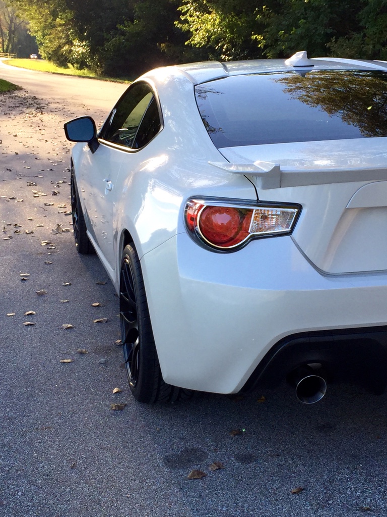

I run a 245/35/18 front and 265/35/18 rear
Raijin same exact sizes and offset
no suspension mods and no rubbing. Hankook V12 all tires brands are little different though.
Hope this helps

Wow car looks great. Thanks man.
You just sealed the deal for me
