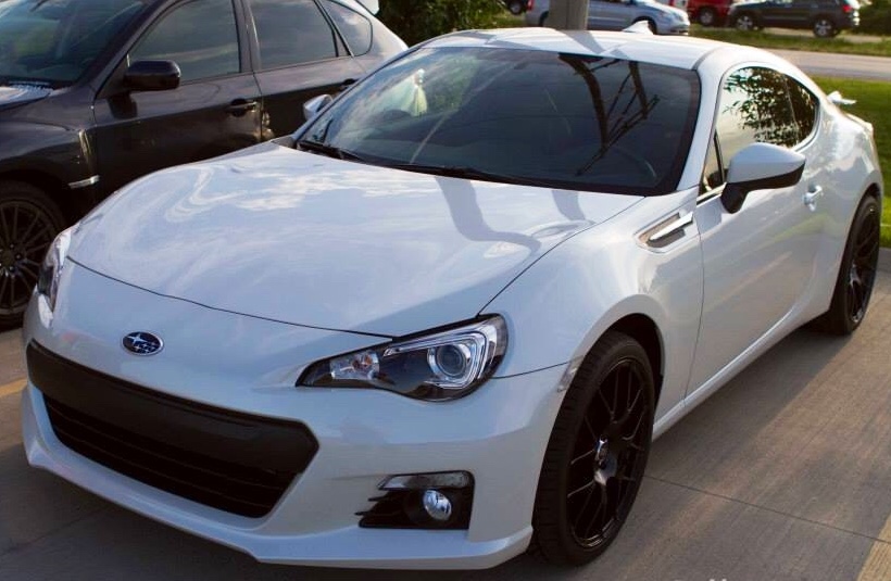

I run a 245/35/18 front and 265/35/18 rear
Raijin same exact sizes and offset
no suspension mods and no rubbing. Hankook V12 all tires brands are little different though.

Hope this helps

Wow car looks great. Thanks man.
You just sealed the deal for me

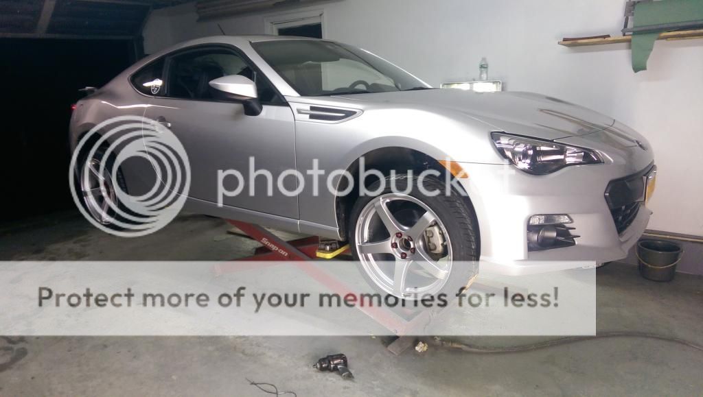

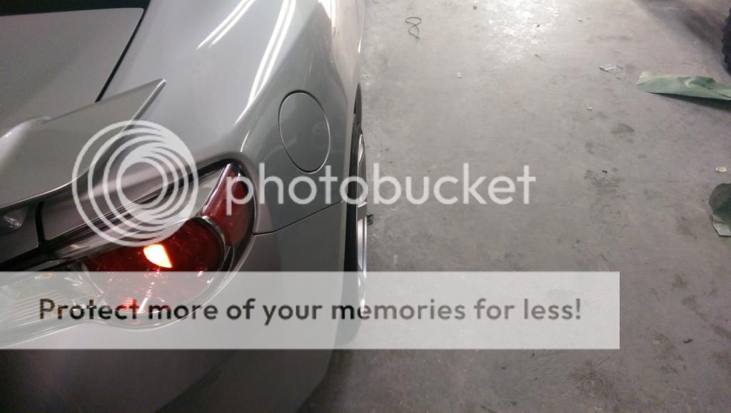

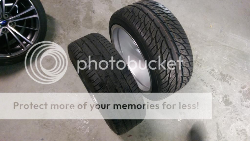

Here they are. Finally.
Old vs New
They fit as perfect as I could hope for
2013 SSM BRZ Limited 6MT
BRZ21 is offline   Reply With Quote

Next time I'll get a little more tire... I should've went with 235/40 265/35 but overall I'm pleased
Old vs New
What tire size did you end up with? Stock suspension still? No rub at all?

225/40f 255/35r
Stock suspension.
No rubbing (at least not yet). I have just less than a finger width between the front spring and tire.
Next time I'll get 235/40 265/35
