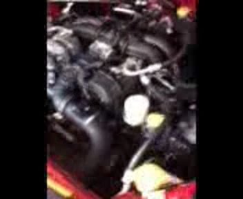

Got it. She lives part 2 SHE RUNS.
Thats actually a video. click it.
It ended up being a bad ground. I had a ground attached to trans and not the body, who would have thought.
