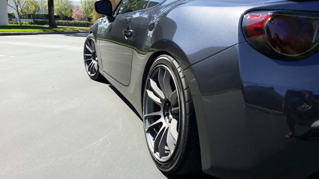

Originally Posted by djdnz View Post
255/35/18 at least. 245 is stretched on a 9.5.
If you want traction, 255 or 265 is what you want.
I second going with 255s on 18x9.5 square. My offset was 40mm. No rubbing issues while turning lock to lock. I'm also on Stance Coil overs.
Sent from my SAMSUNG-SM-N900A using Tapatalk
Attachment 72093
seems like you see some poke on 255 with the 18x9.5 maybe a 10 would be better?
