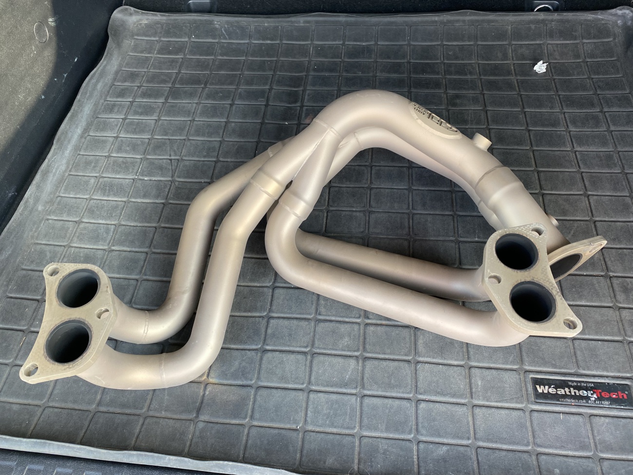

I’m relatively new to the platform so I’d appreciate any advice :P
This is the guide I plan on using as a reference:
https://www.partsdocs.com/Guide/How+...+Subaru+BRZ/39
-renting the o2 sensor from autozone
-ordered the Grimmspeed gaskets for the header side. Will be reusing stock ones for the FP side or source one locally if available at the dealer
-my understanding is that I need to bang on the skid plate a little bit to conform to the header shape
-my torque wrench recently crapped out. Any recommendation on one?
-do I need bolts or can I just reuse the stock ones ?
Anything else I’m missing?

That is a pretty comprehensive write up, you should be fine.
I didn't need to massage the skid plate for my install YMMV.
From memory one or two of the nuts where the header meets the heads won't be accessible easily with a torque wrench. Getting the exact torque isn't critical though.
I was able to re-use existing hardware with my installation but I live somewhere that never snows so again YMMV.

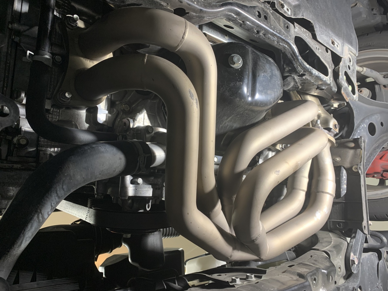

So I got the header installed:
Got the base map loaded on and sent Zach the first datalog. I was able to torque down all the nuts except for the one on the passenger side, mostly because I couldn’t quite get the socket fitted. Ended up just using a ratcheting wrench to tighten it down. Let me know if anyone has a recommendation on fitting a socket somehow so I can use my torque wrench to torque it down.
ihavefat is offline   Reply With Quote
Attachment 211942
I was able to get a deep well 14mm and 6"(?) 3/8" extension on. First the socket on the nut, then slide the extension on between the runners.
PulsarBeeerz is offline   Reply With Quote
Crows foot + extension maybe? (I'm just spitballing what I *think* I would do)

Assuming a 3/8" torque wrench, use a 3/8" to 1/4" adapter and you can sneak in a 1/4" extension between the runners, then put a 1/4" 14mm from the top.

I appreciate the help everyone !! I was able to properly torque it down.
I finished tuning with Zach and the car feels amazing. However, I haven’t modified the skid plate so I do hear a rattle sometimes. And I may or may not look for a catback as the car doesn’t sound that great with just the headers lol
