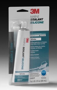

I would just use some tube silicon to seal it all up.

It's in a tube
Originally Posted by huynh_FRanciS View Post
Hello everyone, I just recently install a reverse camera in my frs, and I ran into a bit of a problem. The wires don't fit in the rubber insulator that holds the wires to the trunk, so I routed the wires beside it. Now the rubber insulator doesn't fit back into the hole, and I'm scared water is going to see people inside. I've been thinking about shoving it back into the hole, taping it, and spraying plasti dip on it to keep the water out. Any suggestion on how to do it better?
3m Window weld or Permatex Marine Silicone Adhesive works really well for this kind of application as well

And now that I think of it. Bodyshops/Painters don't like us to use Silicone...they'd rather we use Urethane. Maybe a painter could chime in and explain the details ? I do know that windshields are attached with Urethane. For some reason Silicone interferes with new paint application. Not sure if Silicone also may also promote rust on bare metal ??

Is it difficult to remove if I were to decide to do so?

No. Just get a sharp blade and trim it out. Easy
