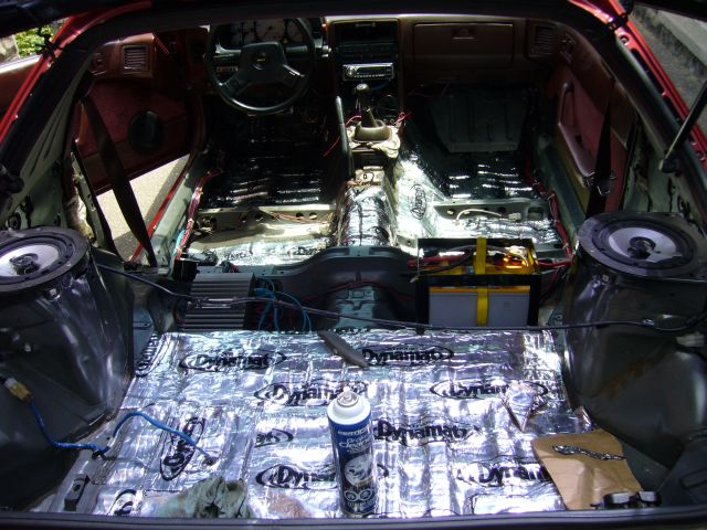

Woah there! These insulators (fatmat, dynamat, etc) go INSIDE the car. You remove the interior panels and carpet and apply them to the car body from the inside.
See:
See:
FC3S! man I miss that car.
