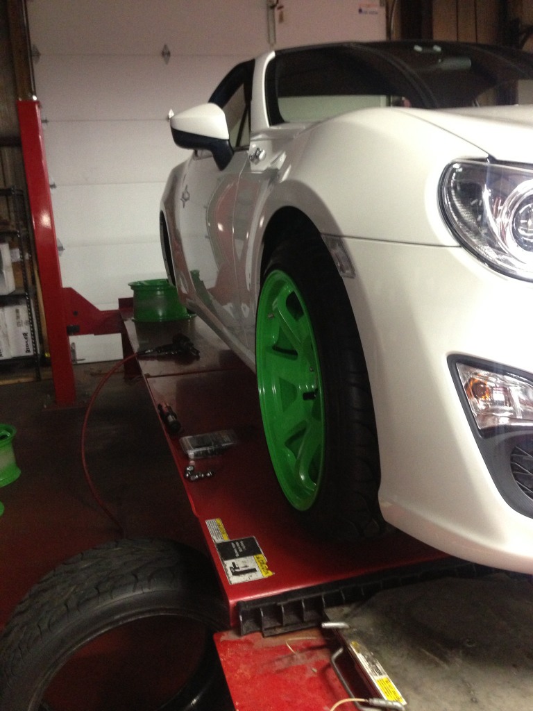

Originally Posted by Verge View Post
do you have any pics so i can see how they fill out??
They poke. Especially in the front. And they are very close to the front spring and perch (if u drop and camber, good chance ud hit)
^ red arrow is pointing to the spring perch, pic taken from below/behind front wheel
