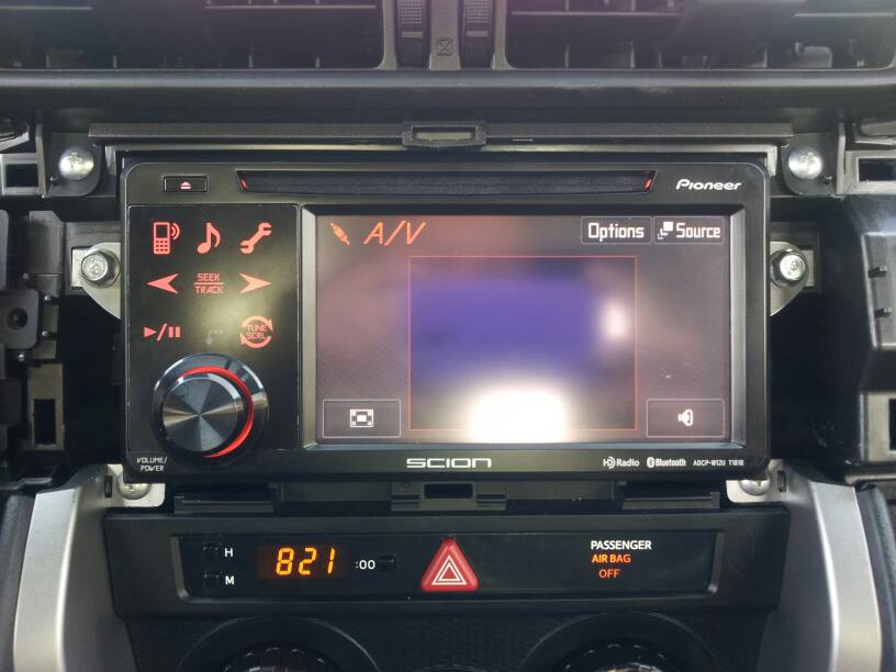

It looks like we might have an easier solution.
Sent from my SPH-D710 using Tapatalk 2
UbSaMrC is offline   Reply With Quote
Old 08-02-2013, 03:22 AM   #9
Acid86
Drives: 2013 Raven Scion Fr-s
Location: Athens, Georgia
Posts: 2
Attachment 36449
Attachment 36450
Attachment 36451
How. Please. How.
Or in non mongol speak,
Could you please elaborate on the steps you took to get to this option?
Thank you.
Acid86 is offline   Reply With Quote
Old 08-02-2013, 04:02 AM   #10
l0aded
Addicted
l0aded's Avatar
Drives: 2013 Asphalt FR-S 6MT
Posts: 1,093
Thanks: 260
Thanked 261 Times in 175 Posts
Originally Posted by Acid86 View Post
How. Please. How.
Thank you.
The USA version (says Zypr powered) does not support this ability. The end.
