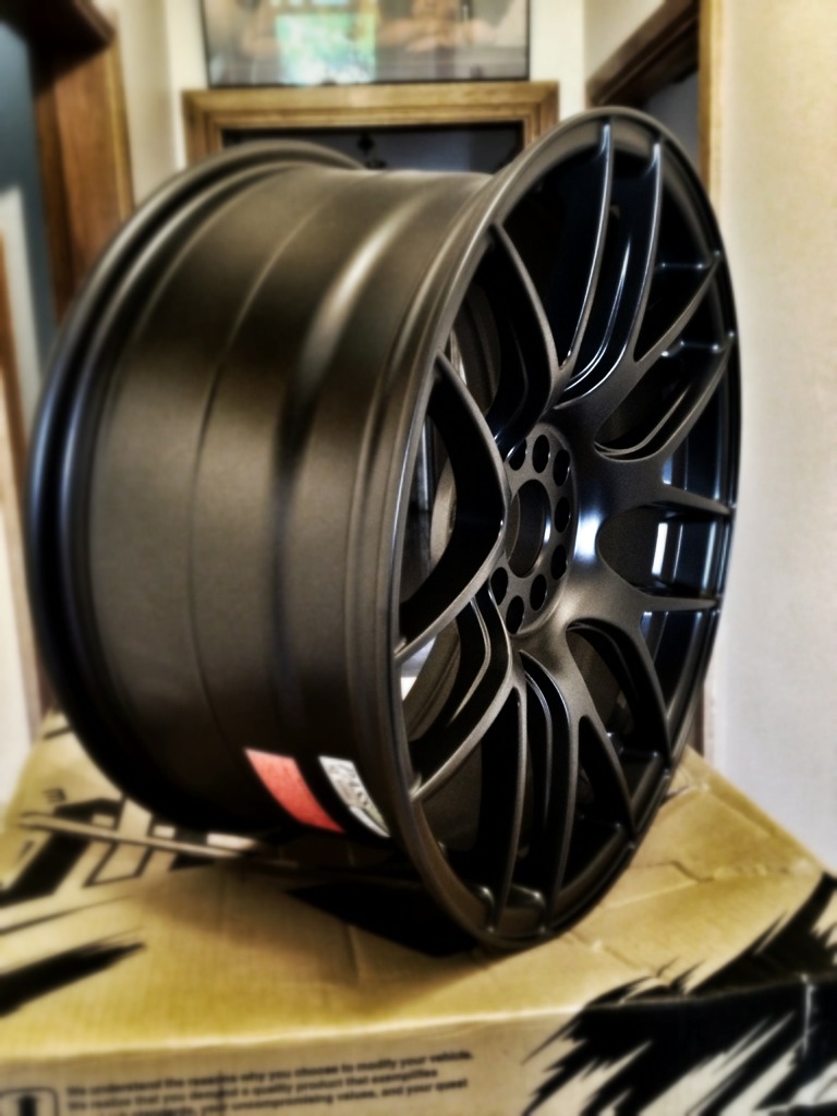

Originally Posted by white_knight View Post
Hey guys,
Finally settled on some XXR 530s in 18/8.75/+33 (square setup).
Attachment 24979
Just shopping around for some tyres. Other than personal preference, is there an ideal size tyre to fit these wheels? I want to go as wide as possible. I'm also planning on lowering about 1".
I just bought these same wheels haha. My post right above yours was about these lol. Where'd you order from?
