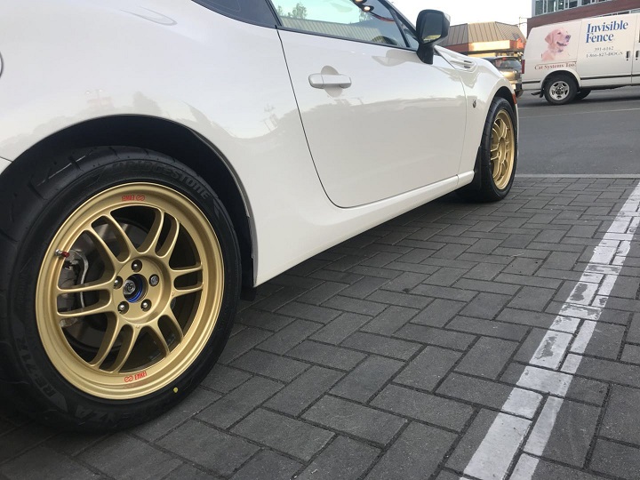

RPF1 17x8+45 re71 245 40 17 overall review
Life is filled with all the things u don't know
Guys buy the set of OEM sensor
RPF1 came with the red valve stems
If u wanna keep u OEM set for winter & still wanna use those red valve stems
Buy it before u go to the tire shop
#rpf1 #gt86 #frs #brz #re71r #newwheels
After sooo many things happen
Here is my over review
1. Make sure r u going to update a big brake kit
2. Choose the wheel & tire size that fit ur car and
also fit the brake kit u will update
3. Check the wheel & tire size with the online calculator
To make sure those will fit u wheel base
Also u can’t check Own review , there is one on our forum
4. Check u OEM wheels is there a TPMS, if so either u can use the OEM
Sensor which usually a one peice deigns with the valv stem on it
Or buy a after market sensor for ur car model
Note: some of wheels come with very nice stem
Buy may not fit any sensor u either use it with tire
Pressure light on or just use the OEM sensor
5. Check out ur OEM lug nut style, there 3 popular styles
And see is the OEM lug nut has the same style with ur new wheels
If not buy the new lug nut that fit ur new wheels
6. Center cap for the wheel , the OEM one may not fit!
7. U need hub ring to install the rim buy it before u install
That my over review for change a after market wheels

Quick update the red stem does not fit any sensors, u either use them with tire light on or just go for the OEM sensors!

lug nut on the way !!!! will upload after i got it
hope i will help some one
oem suspension with rpf1 17x8 +45 245 40 17 all four

lug nut on and center cap
