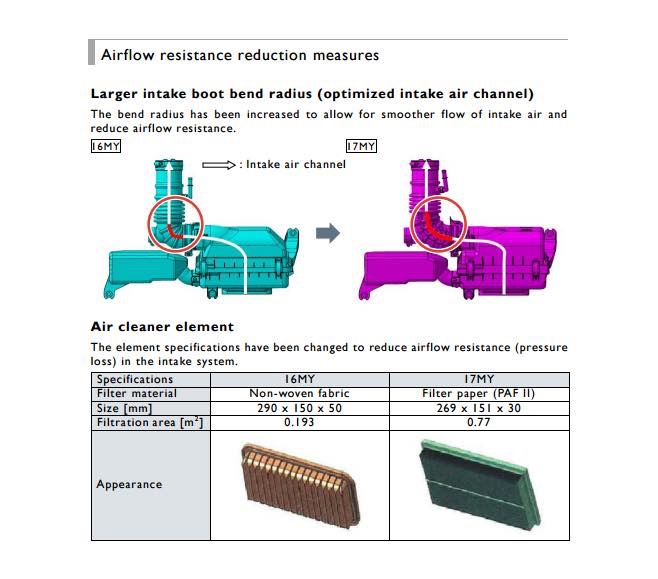

Now, I have a bigger dilemma. None of the existing oil cooler kits I was seriously considering fit on the 17 BRZ, due to the enlarged airbox cover.
Going to test fit a Greddy this week, but if that doesn't fit either, then tracking this Saturday may be a no-go...

Seriously though, this is interesting. Besides Flexfuel/header...an oil cooler is the first mod i would do. In fact it was the first mod on my last BRZ...while waiting on my <cough cough> ACE header to come in.
So Mike please keep us apprised, and do you have a good shot of the new air box...i was not aware of a big change there.
It doesnt look wider, does it just sit lower or extend lower into the engine bay?

It is a fair bit deeper even though the filter it self is smaller.

I would guess it's the shape of the rear section of the OEM airbox. Most aftermarket oil coolers use a sandwich plate that routes the oil lines past that rounded off portion of the airbox (back right on pre-2017 models). It looks like that portion of the airbox is now square on the 2017 models based on that picture.
Not sure what solutions the aftermarket will come up with, but a Perrin-style CAI (long tube into bumper cover) might be an option. The Mishimoto oil cooler might work as well given the way it angles its lines.
