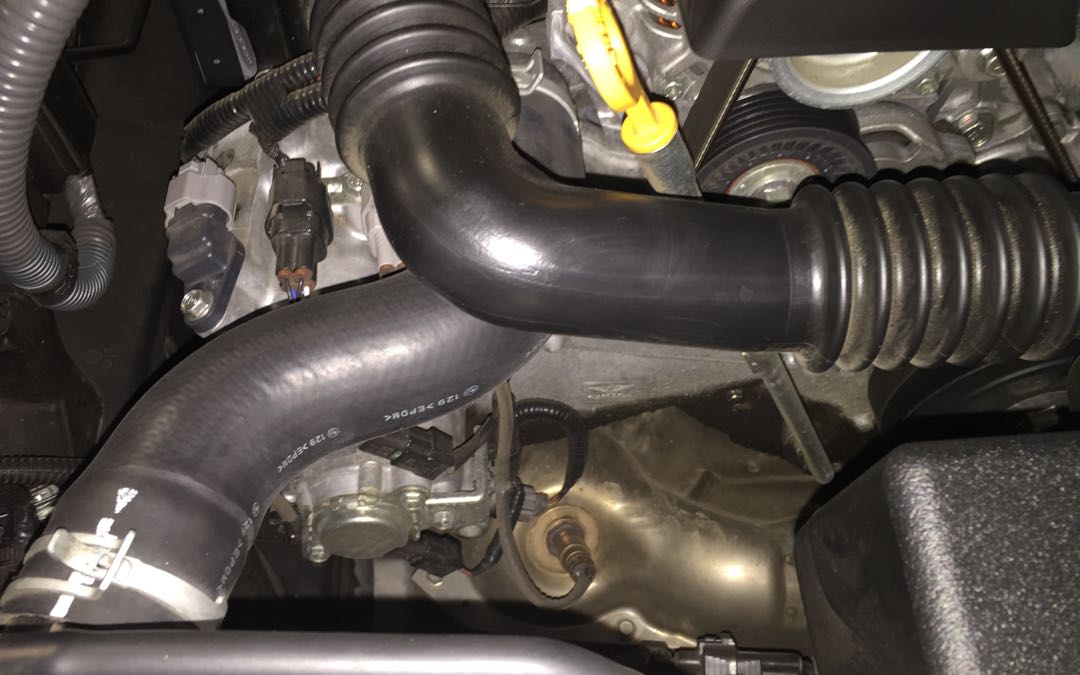

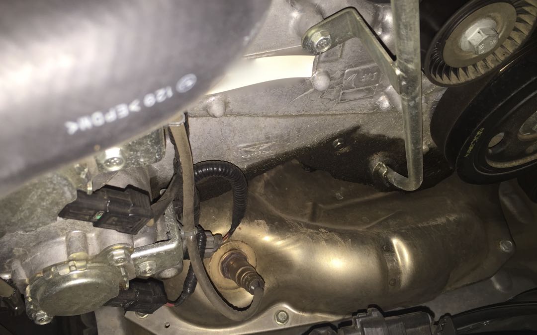

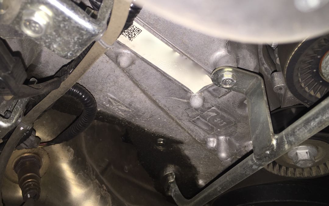

I have a 2013 Scion FR-S that's automatic and has about 33,000 miles on it. The only modifications to the car is a 2 inch Perrin Cat-back exhaust and a drop in K&N Air Filter. Recently I have started to smell burning oil from the cabin, so I looked around in the engine bay and discovered a bad oil leak coming from the front left of the engine. I have looked around and couldn't find any threads or posts about this and was wondering if anyone knew what it was coming from and what I should do? As in, can I fix it or will it need to go to the dealer? I'm still in the warranty period.
Here are some pictures of the leak:

Front timing cover leak. Covered under warranty, will require engine pull.

I'm not seeing this leak... am I just blind??...
Are you referring to that blackness on the block? It looks like undercoating/paint... If it leaked that much, I would assume it to be dripping.

WELCOME to the forum @iPlayDrums ...........
Sure enough, it appears the cam chain cover is leaking.
As a DIY you may consider checking the torque on the cam cover bolts in that area.
Or, better yet, take it to the dealer for an evaluation and fix.
You're kidding right?

This may not be the cam seal. I've seen a bunch of FRS/BRZ have issues with the dip stick area spewing oil from time to time.
The timing cover bolts are lower than where the leak/seeping is in your photo. So I'm leaning towards the dip stick issue theory.
Regardless, get it to a dealer and fixed.
- I had the dealer pull my motor and reseal my cam areas. They did a great job.
