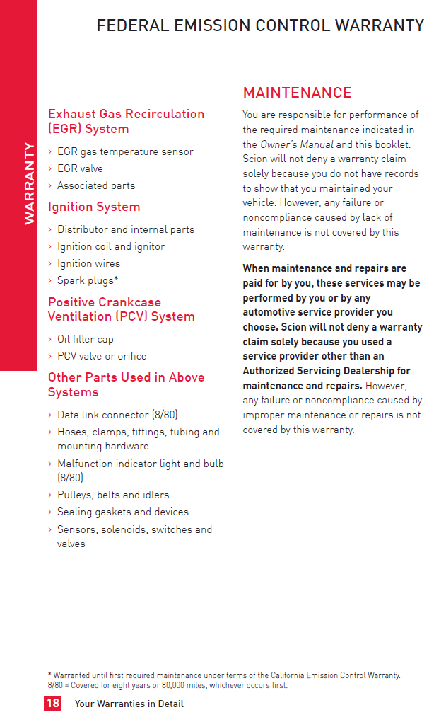

I believe legally as long as you have the work done by a professional the manufacturer can't deny the warranty coverage.
But I guess they COULD say the non-dealer mechanic that did the change messed up and you need to sue him. That would be really uncomforable for most people, who have some kind of relationship with their mechanic.
It might be worth consulting a lawyer re this-- if so most manufacturers could deny coverage to most of their customers with slightly older cars.
Per the "Warranty and Maintenance Booklet" in every single car's glovebox (this is the Scion version 2013) shown below. Note that this is a legally binding document detailing the warranty and is easily accessible to every single owner, no need consult a lawyer.

The problem, as described by the OP, is that Subaru has taken the stance that he has one oil change interval that was not performed by the dealership, so they are taking the stance that the oil starvation was caused by that oil change. Of course, the burden of proof is on them to show that, but as evidenced by the OP's experience, lawyers did have to get involved. So yes, while we as consumers have rights clearly laid out in writing, they can still make life pretty miserable for you by claiming failure was caused by improper maintenance since they didn't do it.
