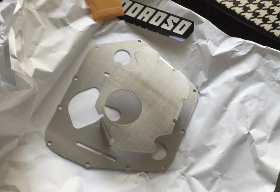

I have the moroso oil pan installed for cheap insurance. Name:  ImageUploadedByTapatalk1417583952.886381.jpg

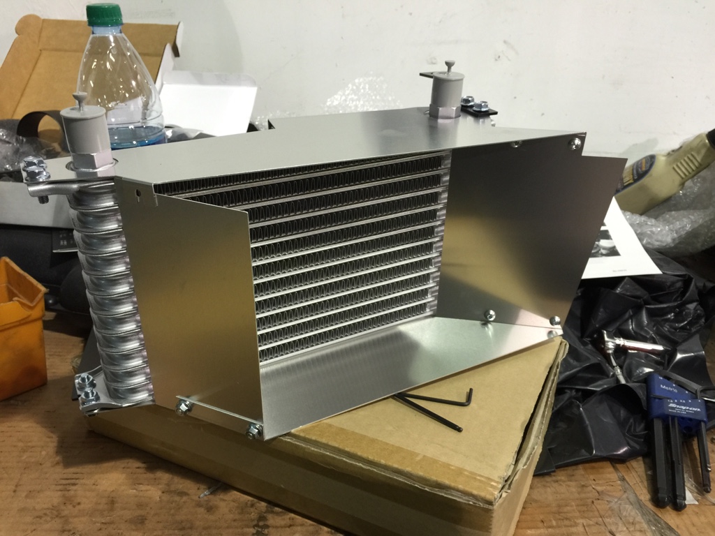

I also did an oil cooler and pressure gauge.

I :heart: cooler shrouding.

Things you can do for STX:
-Mounts
-Accessory pulleys (and belts)
-Oil pan & pickup
-Oil Cooler
-all the intake & exhaust & tune stuff
Sadly, clutch must remain stock or stock-equivalent.
conedodging is offline   Reply With Quote

I was under the impression that oil pan must remain stock in stx?

Oil Cooler was approved in Dec. Fastrack for ST* is legal for 2015.
ITEM 12) (#12449) Street Touring® Category section 14.10.A, ENGINE AND DRIVETRAIN (page 85)
Add: Engine oil, transmission fluid, and power steering fluid coolers may be added or substituted (including oil to coolant heat exchangers) but may not serve any additional purpose.
Oil pans & pickups have been legal since at least this year.
14.10.A. Oil pans and pickups may be modified or substituted. Addition or
modification of windage trays or crankshaft scrapers is not allowed.

BUT, it is a lot easier to do some of that stuff (oil pan) with a motor that is off the car. So if it's in budget, why not?

So someone says yes to oil pan and someone says no? I'd really like to do the oil pan for sure, since I'm sure I'll end up doing a few track days here and there.

Cooler was just approved for next season.

In our non-humid climate I don't think a oil cooler is needed for autoX IMO.
