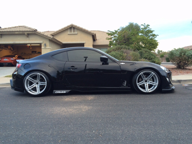

Posts: 331
Thanks: 7
Thanked 142 Times in 74 Posts
Mentioned: 23 Post(s)
Originally Posted by mikesagas View Post
anyone tried 18x12 +20 offset in the rear? im getting this type of wheels but i dont know if gonna work i have coilovers, anyone can help me?
I'm running 18x10.5 plus 22 offset on Ksport coils pretty close to all the way down and 2 1/2 inch conversion spacers if this helps.

Old 01-21-2015, 11:45 PM   #104
Kwise1
Kwise1's Avatar
Drives: Raven FRS
Location: Litchfield Park, AZ
Posts: 331
Thanks: 7
Your going to have to do a lot of cutting to the rear bumper piece just so you know

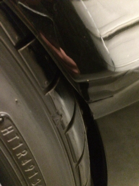

Old 01-22-2015, 01:03 AM   #107
Kwise1
Kwise1's Avatar
Drives: Raven FRS
Posts: 331
Thanks: 7
thanks!! i thinking about getting these wheels with a 1.5 spacer? can make it with that size?
I'm not sure what spacer size you'll need.
But consider this your wheels are 1 1/2 inches wider than mine
I'm using a 2 1/2 inch spacer to be flush with the fender
The camber I have is only from the coilover drop
So in your set up I would look into a 1 inch spacer but you also have to consider the offset of your wheels as well

Old 01-22-2015, 01:40 AM   #108
Kwise1
Kwise1's Avatar
Drives: Raven FRS
Posts: 331
Thanks: 7
cutting? not only the cutting for the rocket bunny wide body? explain please... and thanks!
To fit the wheels flush with the fender you'll need to cut this part of the kit or it will rub.
