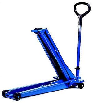

...my jack already barely clears the stock height.
Would this AC Hydraulics unit possibly work better with a dropped car: http://www.pelicanparts.com/catalog/...ACHyd1_pg1.htm?

What is your goal lowering? I would love for a nicer look by lowering but my jack already barely clears the stock height.
This jack from Harbor Freight will clear RCE yellows. I know because I have this jack and I used it to install my RCE Yellows. You have to be careful though; there are two nearly identical jacks. One is 34.5" long and one is 39.5" long. Get the longer one.
You also have to be careful because your buying a jack from Harbor Freight. J/k (sort of).
