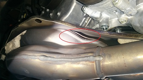

Good video and driving etc, curious the gaskets and the mention of the header splitting. Is this in your opinion all from the heat itself that's caused it?
oh I am pretty sure the header failure happened due to restricted flow and high EGTs (or combination of both) so the heat was the factor, many people also had some sort of issue that day my oil temps skyrocketed (my mistake of course but I was , my friend with a Miata had some shifting issues (damaged the fork I think)..etc
so the word of advice, if you track your SCd car get an aftermarket header of some sort..too bad though I really wanted to keep the OEM header as the design and heat shield (well it's OEM ) and I am not really big fan of aftermarket parts, oh well..

@glamcem: those failures would indicate to me that either your EGTs are (way) too high, or you went off during a rain session and the rapid thermal contraction caused a stress failure...
Please get me a log! You should be seeing no more than about 1420F or so. *peak*
Or he's over stressing the header mechanically as I don't see any discoloration from over heating. I'd also check the condition of the motor mounts.
Mike, as I mentioned earlier I completely forgot to log at this last event (yeah, I know) .. it could be the combination of both too since it felt the humidity was also a bit more and we had some afternoon showers the day after so maybe it was just my luck.. at this point I am not sure if I should grab another OEM header and give it a shot ..but the guy at the exhaust shop advised me to get an aftermarket one since the lack of flow/diameter may caused this high EGTs.. I am thinking to get a Borla and directly send it to the ceramic coating place in our area (2000F ceramic coating)
I kinda doubt it but I will check the motor mounts too

@CSG Mike
do you recall what kind of setups and conditions did they have when they cracked the OEM headers?
I've seen headers (and cats) crack/fail from high EGTs with the FA20.
