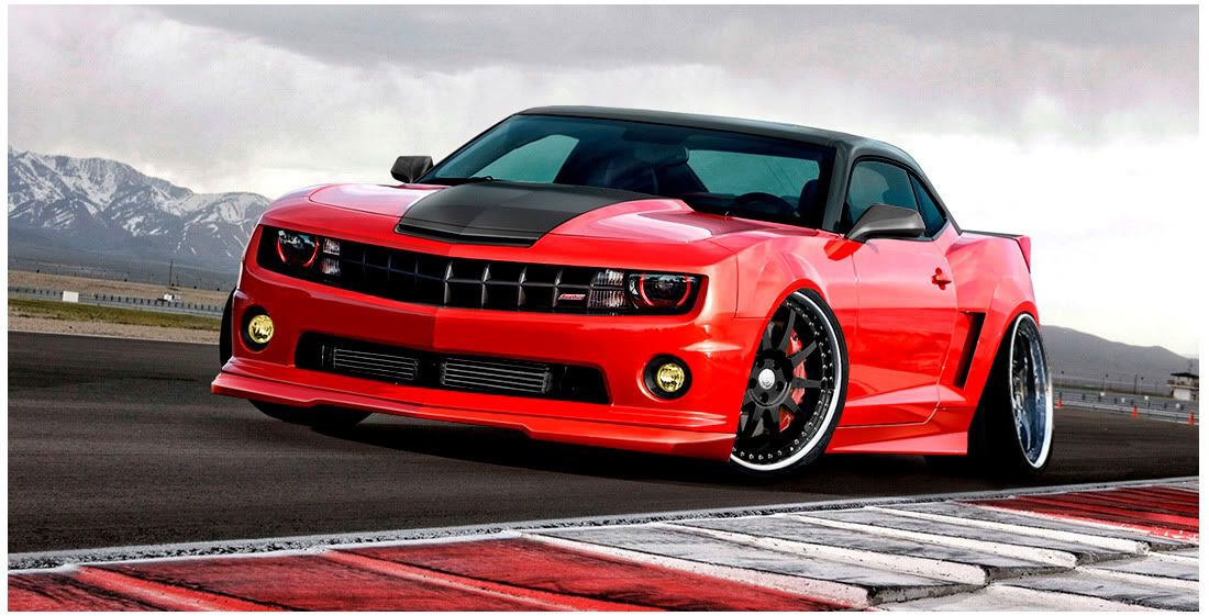

Originally Posted by Kolian View Post
As I said before I rarely drift ever since I got new rims and tires I drifted about 5 times. And I couldn't have wasted that much tread in those five times no matte what I do.
I don't think the drifting is the problem.
Does your car look like this?
Admittedly exaggerated, but out-of-whack rear camber will do exactly what you're describing.
FlamingRectumSyndrome is offline   Reply With Quote
No it does not look like that my rear tires are straight with my fenders and looks fully straight all around the car no camber and nothing like the picture.
