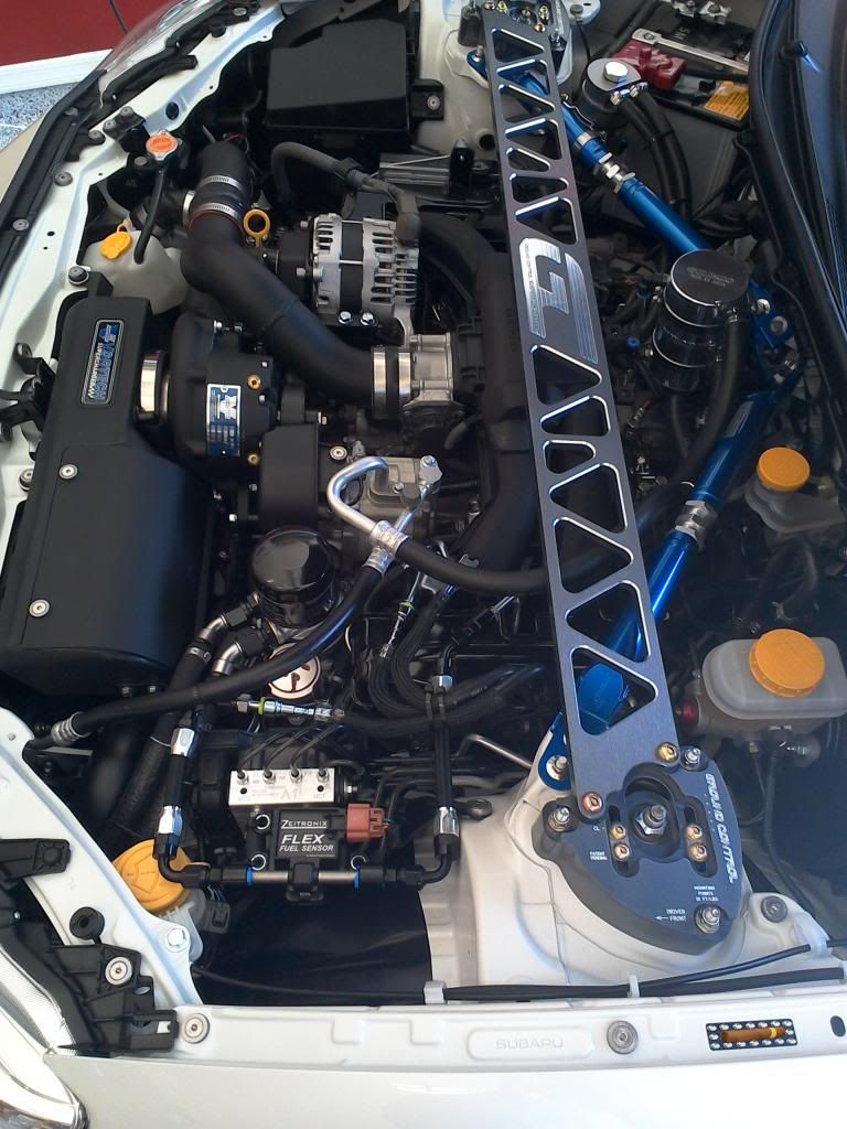

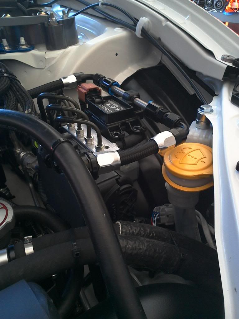

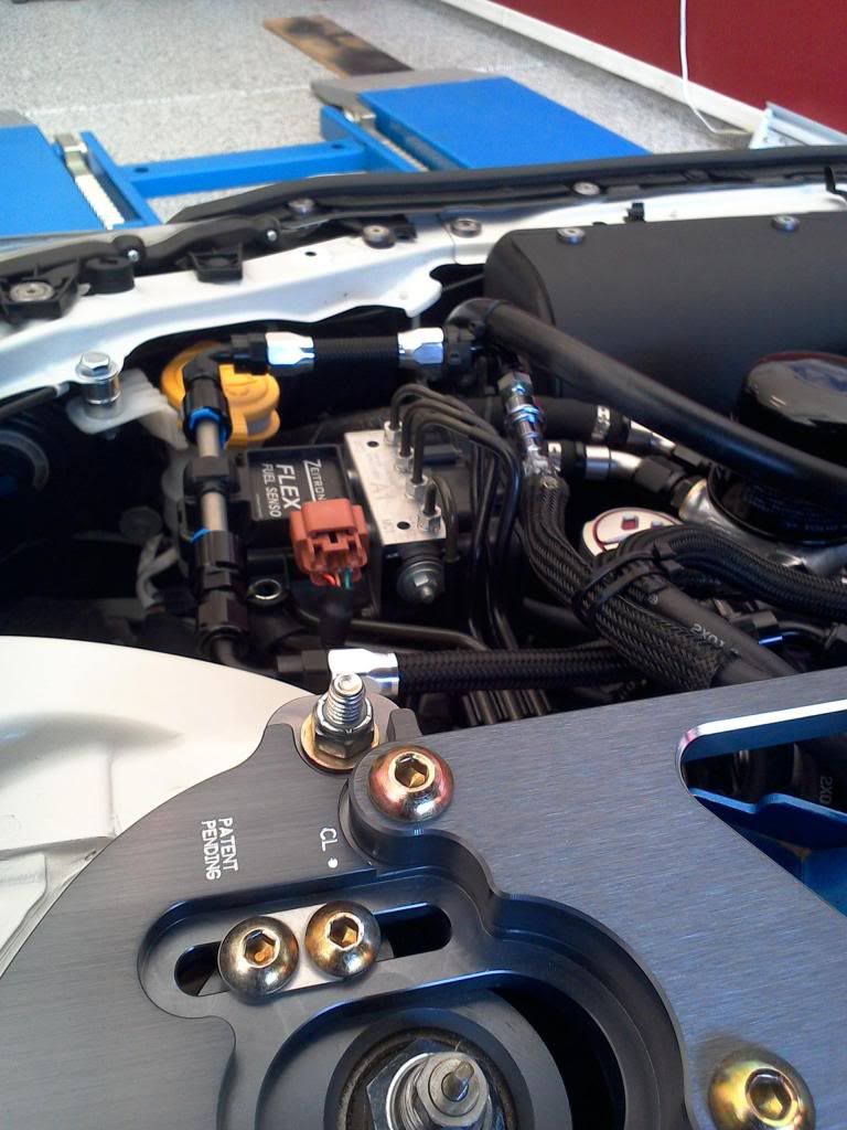

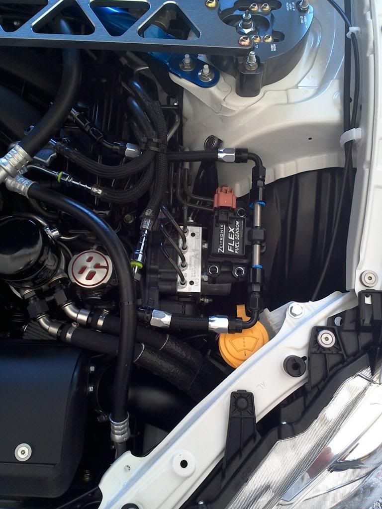

So for those who may have the Vortech setup, you may run into a slight clearance issue that is really not that big of a deal. Just to be aware of it so there are no surprises when you go to install your Moto-East FF Kit, here is what you may run into. So the Vortech systems relocate the washer bottle which in turn requires relocation of the filler neck. It places it right where the forward most FlexFuel line sits as you can see in the pics.
So what needs to be done is the filler neck needs to be lowered and then remounted where Vortech has you mount the filler neck with some spacers. I just happen to use some spacers I had laying around but you could pretty much use anything (nylon, aluminum, and steel spacers can all be purchased at your local Ace Hardware). Obviously you would then need to grab yourself a longer bolt with washers and a nut while your there. Again I just used what I had on hand. In addition, to get myself just a hair more clearance to get the filler neck cap on and off easily in the rare event I actually need to fill it I placed hoses I had laying around over the brake lines to lift the sensor a tad and it eliminated any hard parts from being in contact with one another (Not really concerned with that but this happens to kill two birds with one stone). Again you will see the hoses on the lines in the pics. Just slice em down the center and slip em on like a wire loom.
