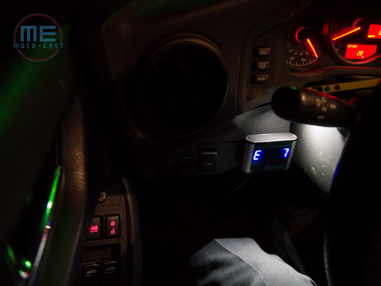

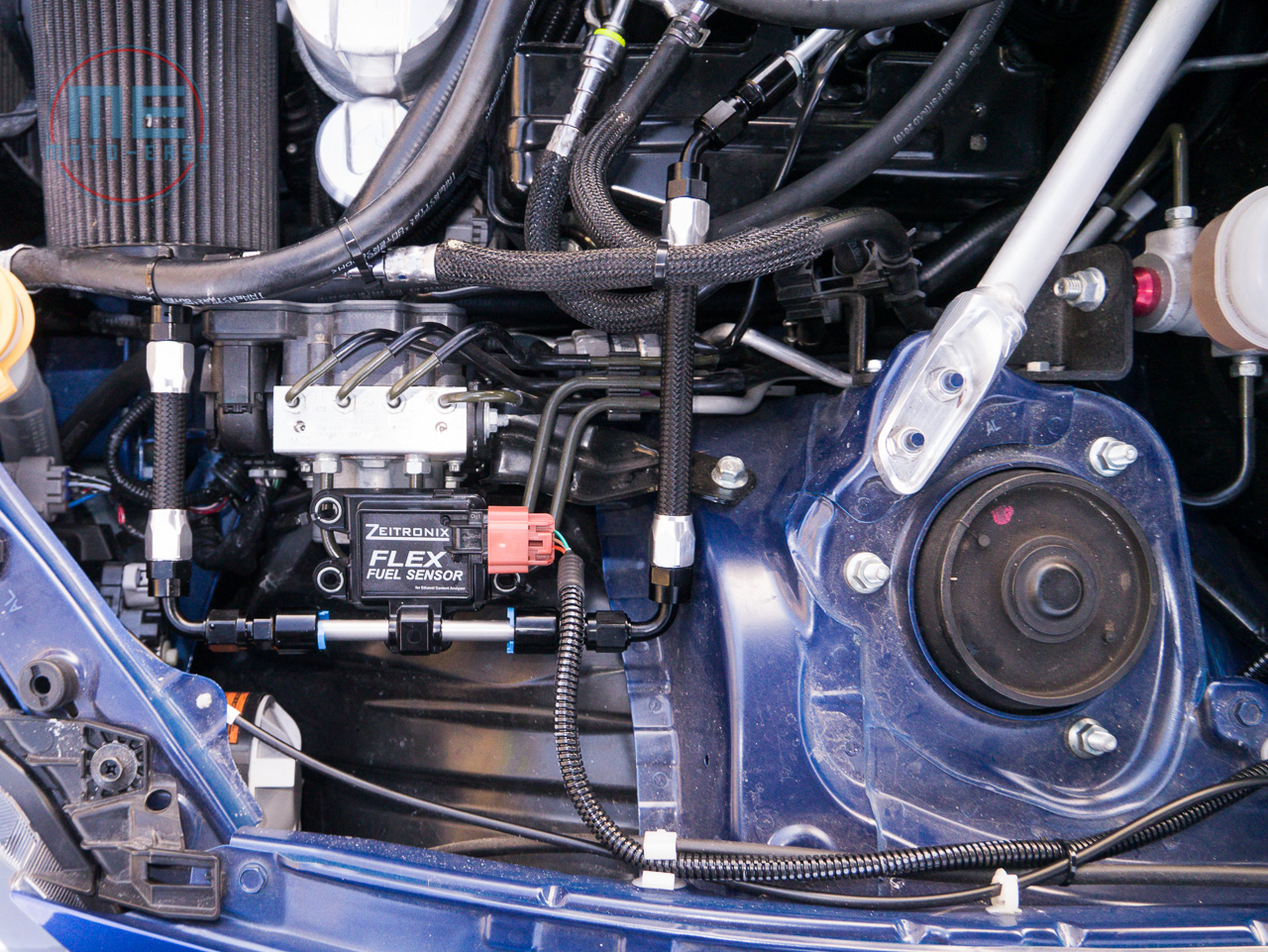

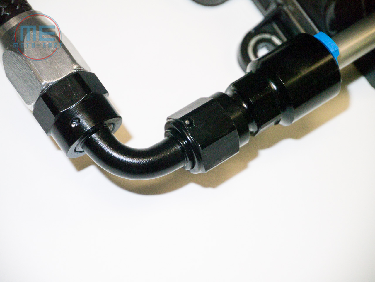

We'll let the pictures do the talking, but here's what is included for $650
Zeitronix ECA with gauge and sensor
Ethanol compatible hose
Name brand AN anodized fittings throughout--no clamps, no plastic
Push on fittings and 100% reversible with no cutting
Minimalist routing. Look at the picture of the kit mounted. You won't find unsightly looping lengths of hose here
Simple sensor mounting. Ties right to the lines and is as solid as can be
Wire harness for ECU
There are four wires to hook up: Ground, IGN-ON power, sensor IN and ECU output. All crimps/connectors included and terminated where possible.
You can also choose to use the rear o2 instead of the ECU harness. For this you can save 100 and that makes this the most affordable complete flex fuel kit out there!

Good bit of kit, a few questions if I may:
Why ECA instead of ECA2?
Why not use all black anodised fittings?
Why use zip tie to mount the sensor?
Why is there no protection between the paint on the strut tower edge to the non- black anodised fitting?
Xero-Limit 02-17-2014 10:17 PM
Originally Posted by jamesm (Post 1536910)
Looks awesome! Can you do a package with just the lines and fittings for those of us who already have the sensor/ECA or have the old flexfire setup?
We can, for those wanting that you can PM for details. Expect it to not be a huge savings though because we don't make much on the fittings, and they take a while to assemble.
1. Packaging and display.They function identically but no extra box with the ECA.
2. Why use all black? We can make them in all black, blue/red also. We like the silver/black combo. It is fully anodized, just silver/black instead of all black.
3. More secure than double sided tape, does not require tapping sheet metal, and keeps it off of the plastic fender liner.
4. Because it is not needed, there's a gap there.

xxscaxx 02-18-2014 09:31 AM
Hey you took my mounting spot!!! LOL
Little tip Mike, instead of using the zip ties, get some line clamps with the rubber on the inside and use some stainless bolts.
http://i15.photobucket.com/albums/a3...ps1wg37eu4.jpg
