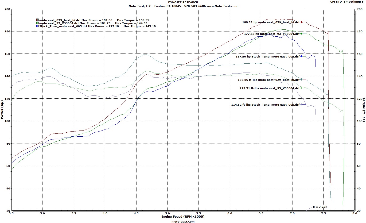

...actually E70 as it is winter and E85 is not yet available. However, in testing various blends throughout this process, it is a non-issue other than a few more HP! All are selectable and you don't need the variable sensor (though it would help for consistency)
We started with the pump gas and added some timing and fuel to zero out the trims and get an idea as to what else needs changing. After a few hours on the street it was clear we're at a point at which the knock sensor is no longer a guide for best torque, as it is nearly silent past 50% ethanol. So we get it to the final 70% available concentration, put in some conservative numbers, and strap it down. Blue is stock, green is pump gas tune, vomit color is the street estimated e70 tune, and reds are the best torque and best hp maps (now combined).
Then looking at the ethanol dyno we can see the gains down low and midrange:

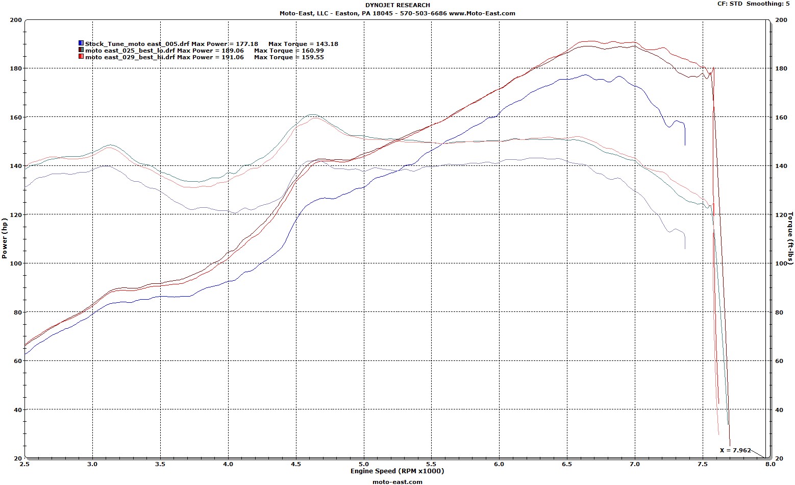

And we then tweaked a few other things which ended up dropping our low end (as expected, wanted verification on the dyno) but got our top-end even higher.
So the final mapping is using a combination of those.

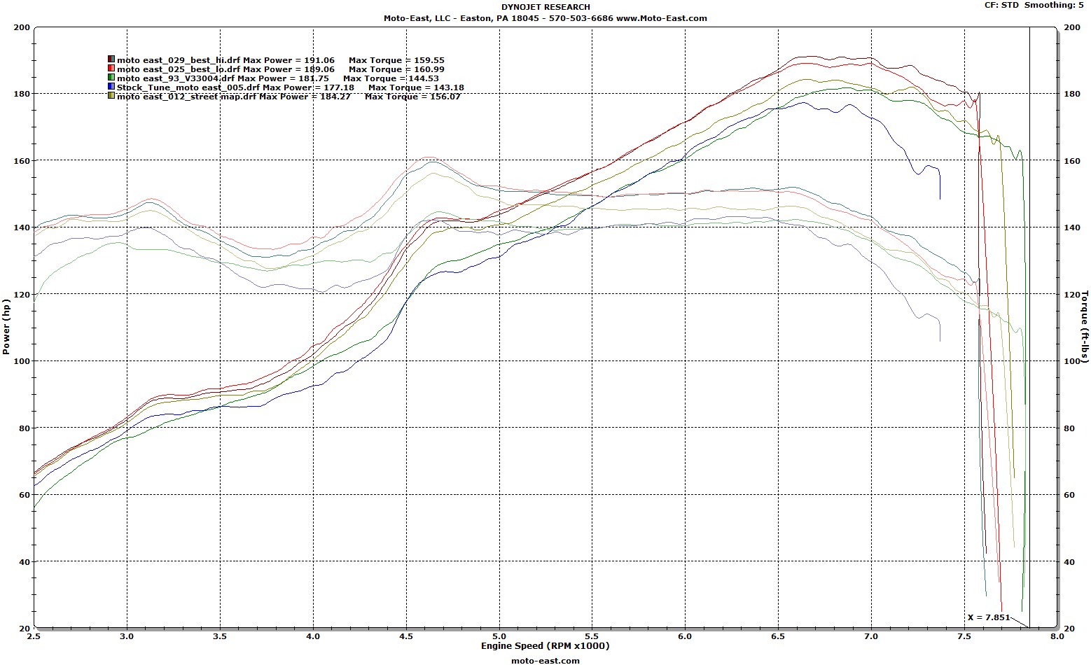

Below is the stock vs E70 tunes:
Overall these are HUGE gains on a 2l car, I honestly did not expect it to be this good! All runs were done in 4th gear, though the stock and pump gas tune were on colder temps so I expect we could have had even more gains today! We're also using the strongest stock map out of all the pulls we did to give subaru the benefit of the doubt. Car has bolt-ons (intake, exhaust, stock header) but truthfully the stock (but tuned) car performed quite similarly, just quieter and maybe 5 hp down. Of note, we were running on a dyno that historically reads 5% lower than the other dynojet we use which reads the same as a mustang dyno in the same place, so I have no doubt we can hit 200whp, especially when the header arrives!
