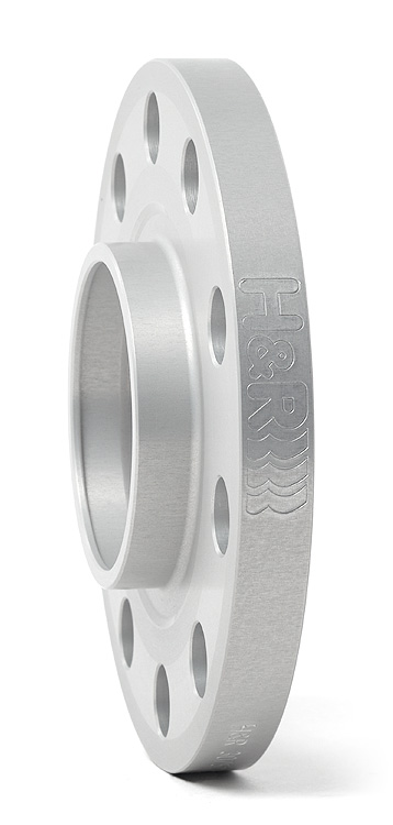

Yes, or go with the NT03's as their offsets are more FT86 friendly.
FYI, quality spacers like the H&R Trak (as posted) will come with the extended studs FYI.

Thanks for the heads up. One last questions, If I go with the NT03's whats a more reasonable offset to go with for our cars?
x Naq o is offline   Reply With Quote
Depends on the width. I think the 18x9.5 are available in +40 which is perfect with coilovers. 18x8 in +35 also is common. There's also a wide range of colours available (silver, SBC, black, white, gold, etc....)
Check out the vendor forums for group buys, I'm sure there's a few going on at the moment.
