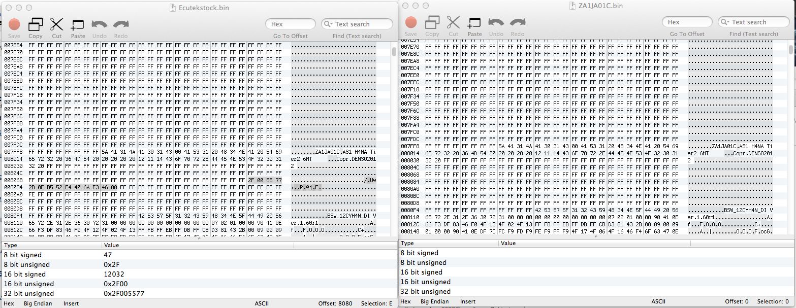

Originally Posted by shiv@vishnu View Post
Here is your ecutek "stock" ROM compared to an actual stock ROM:
You can see some non-stock data where there should be FFs. This also changes the checksum data at the end of the ROM (not shown).
Until we come up with a way to flash non-stock and old ROMs to new stock ROM status, I've added your ecutek "Stock" rom to the database so it should work for you now.
soooo.....now v1.53 is released
v1.53b Changes:
-Replaced the stock A01G and A01D ROMs in the database with actual stock ROMs.
-Added a “stock” Ecutek ROM to the database.
If anyone else with one of the supported ROM types doesn't get tuned map file generation, please email me your original ROM so I can compare it to the counterpart in our map database. If they aren't 100% identical, tuned map files will not be generated. I will have to add your original ROM to the database.
Cheers
shiv
OK.. so forgive me here. What does this mean??lol
Vlady is offline   Reply With Quote
Ecutek have written extra bits of data into the "stock" rom in areas that are just padding or spare space ie ""FF".
This may be for various reasons, but likely to be so that ecutek can identify the ROM as one of theirs for licensing/locking tune ect or that Ecutek has written to this ROM/vehicle at some stage.
Ecutek can also add extra features to their ROM's (RaceROM's (not this one as its a "stock" ROM), to do this they patch the original ROM's instruction code with extra code (program instructions) to perform extra functions such a map switching. this extra code need's to be inserted in "spare" or unused spade in the ROM usually this will be filled with "FF". The extra code data for alternate maps ect is usually inserted in this unused space. These ROM's are also locked/encrypted such that an ECUTEK licence is required to access/flash the ROM's I believe not even dealers can access/flash ecutek locked ROM's
Well that the way i think it works anyway.
steve99 is offline   Reply With Quote
