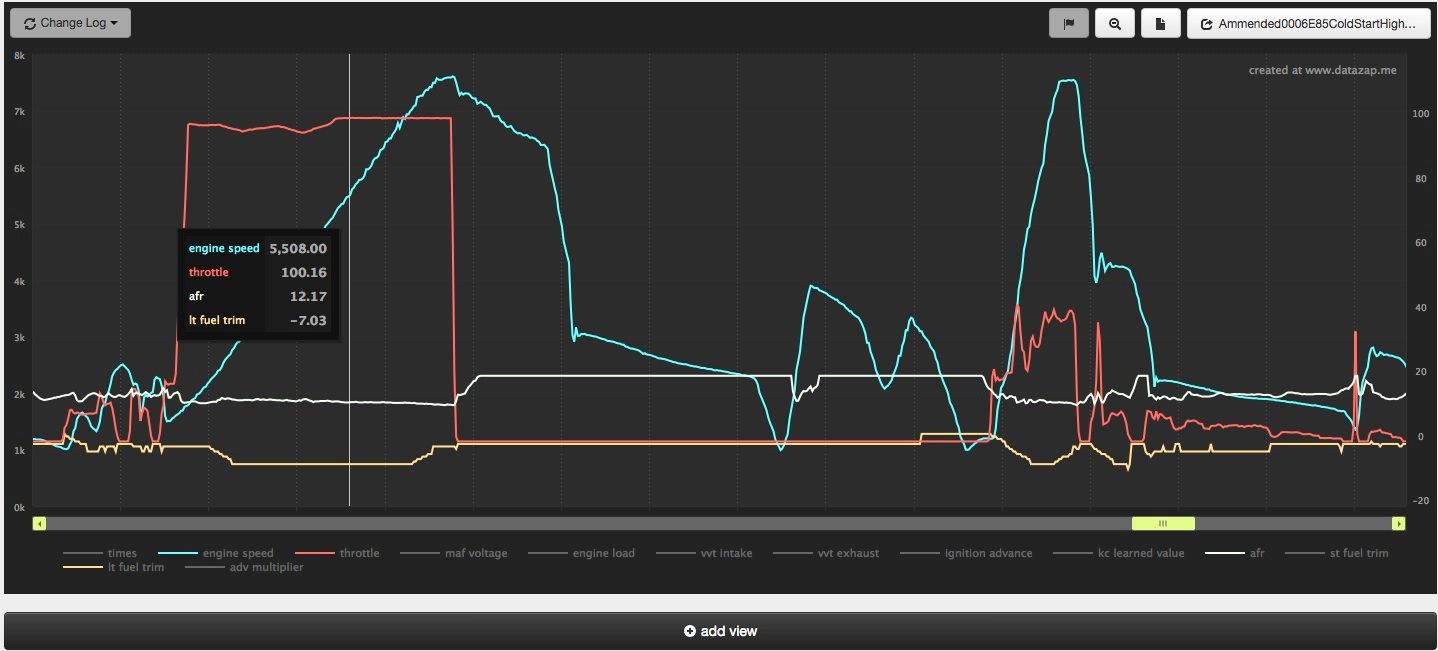

Originally Posted by Luckrider View Post
I was just wondering if the intake/exhaust advance was to account for the header.
I'm on my 3rd tank of e85 and with my log with the longest time before flashing (probably 300 miles) had the highest ltft down to .74%
http://www.datazap.me/u/luckrider/e8...og=0&data=1-11
Edit: There is a 3rd gear pull from 1500rpm at ~1500s on that log.
A section of your previous log (which had more driving/learning time):
Notice how your LTFT under load dropped to -7.03% to account for the lower ethanol content in your fuel. Expect to see the same behavior with the new map (or after every new flash) after some more driving/learning time. Right after your flash, LTFTs will be 0.0%. As you drive more, they will start to move in the direction you need them to move in order to achieved the desired AFR under load
So the -% in LTFTs helps lean out the car a tad to accommodate for the higher dino content of the fuel? I am not upset at all that my station is pumping low E since it is terribly cold here. My car starts right up without messing with the IPW. Vra vra vree VROOM! is all that it takes every single time.
Exactly
I agree. Having a lower E content is great for the reason you mentioned. Plus, it's overkill to run E85 on an NA FA20. It will get all the cooling/octane it needs to make max power at somewhere around E60.
