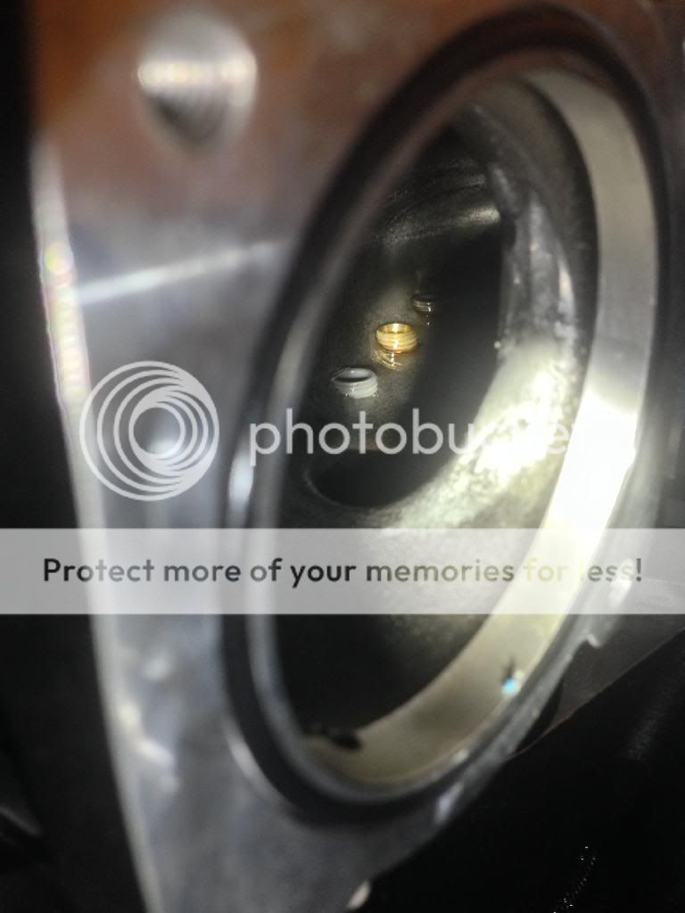

Yeah. It's not a great picture but you can kinda see the oil pooling around the plastic fittings. The whole elbow has a nice oil coating. This was right before I installed my catch can.
[IMG][/IMG]
I experienced the same thing as well when I pulled my charger off to install the intercooler. Will be installing a catch can soon, want to try and wait for the radium specific kit for the twins though.
