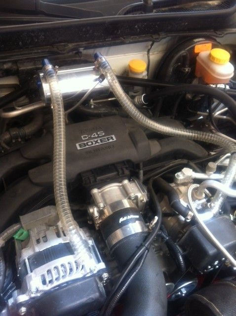

well... my car throwing CEL+TRC Lights keep me wondering plus boost creep etc I was thinking what the hell this catch can hose hanging over there. the mechanic keept the right hose zip tie at struce tower it was not caped or anything its just keept open to atmosphere.. do you think this is the source problem of CEL boost creep aren't this doin vacuum leak etc?

Can't see that causing boost creep that's just crank pressure. It's odd that he has the one side just open like that, most remove the pcv and put that hose in its place.

Originally Posted by whitefrs View Post
What CEL code
Sent while popping Mollys
P0441 and C1201 those poped after leaving gas staion popd after 6-8min while cruising home
hmm ill keep it like that but how can i connect it to pcv there is one goin from intake to down near firewall

Originally Posted by Alhammadi View Post
Their instructions are incorrect, please don't follow them.
Correct installation of a catch can:
http://www.ft86club.com/forums/showthread.php?p=654722
No build thread. I don't want to be reminded of how much money I spent.
[insert profound quote here]
arlgith sounds good they connect the other hose to intake pcv what about the one down there at frewall can i keep it open? or should i cap it?
No side is to stay open
http://www.ft86club.com/forums/showthread.php?t=21079
so i cap it with anything like plastic scrow stuff like that?
