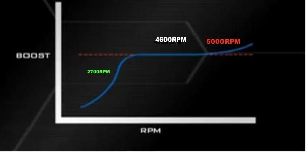

greeting.. boost rise when set to10psi the problem now is boost hold all the way. when RPM Climb around 5000+all the way redline boost creeps higher and higher around 12-13. anything should be warry about it? i just cant keep goin seeing creep like that for safety to engine i pull my foot right the way!!
solutions for my issues i'll be much pleased..
