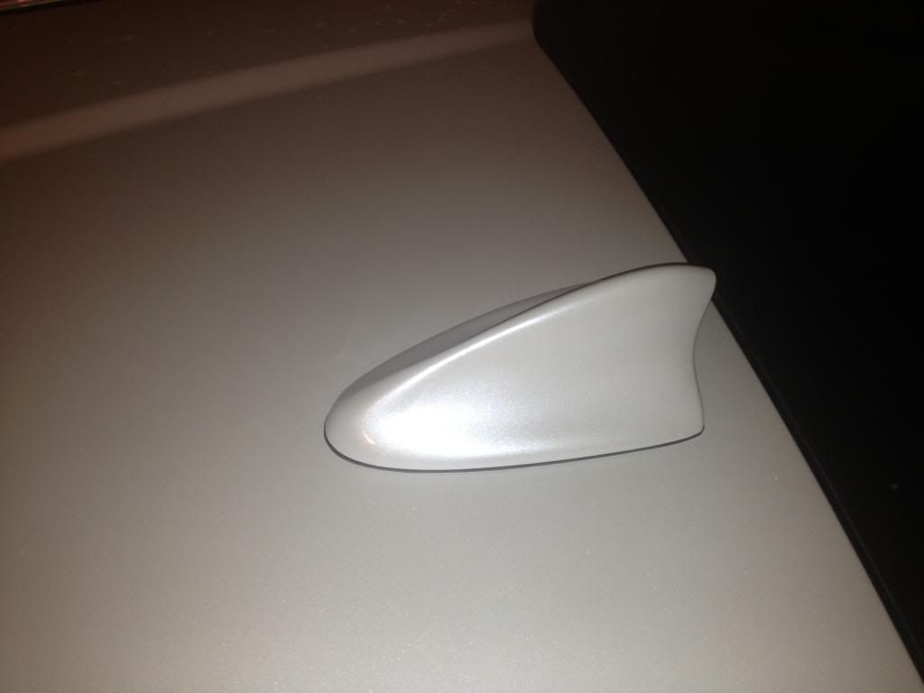

Originally Posted by Chaetagnath View Post
Finally got my VG shark fin. Satellite antenna fits perfectly.
Chaetagnath -thank you so much for your post and pics of your VG sharkfin. I just received a sharkfin from Beatsonic and it will be too short to cover both the regular antenna and the XM one for sure... I will have to return the Beatsonic and get the VG. I am new to this site and just learning how this works. When we order we get a group price but cannot return it for any reason is this true? another question, is it ok to get my XM installed by a third party not at the toyota dealer ? I did order my tuner and fit kit already and it is a toyota part so I was thinking that should be fine( wont void my warrentee on my FRS??)

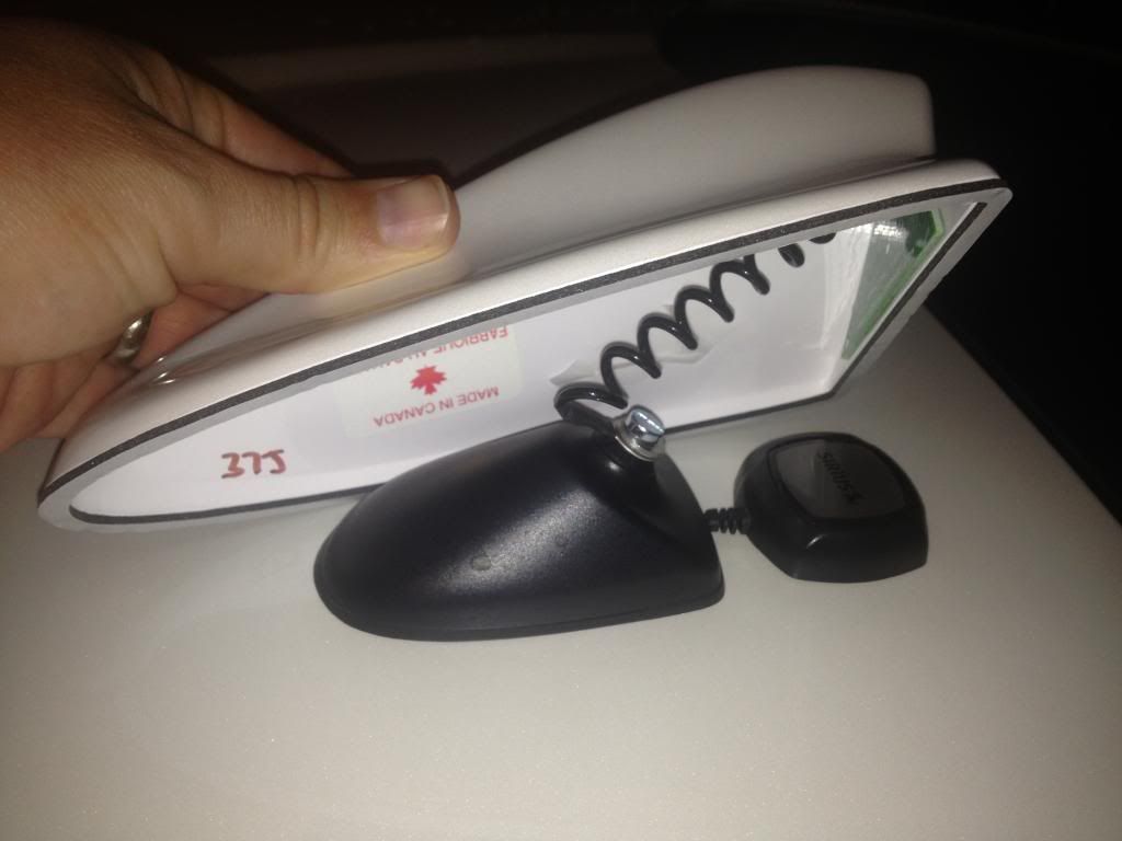

You don't have to return the Beatsonic antenna. A small sat radio antenna does fit under it, you just have to mount it up in the SF antenna. I used a hot glue gun to secure my sat antenna and the stock antenna base helps hold it in place.
You would need to contact the group buy point person to answer that, but I would try to make it work with the beat sonic first per kmbkk's suggestion. As for the warranty, you would need to ask Toyota to be sure, but given that it comes sat ready, it shouldn't matter who installs it to keep your warranty intact, and if it did void something in the warranty it would only be related to the stereo system. This install really doesn't change anything on the car, you are just running wires to the stereo. In fact the only tricky part really is making sure the shark fin is on straight.
