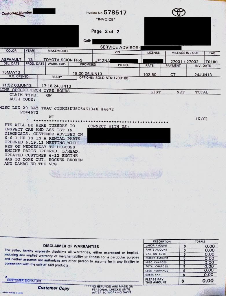

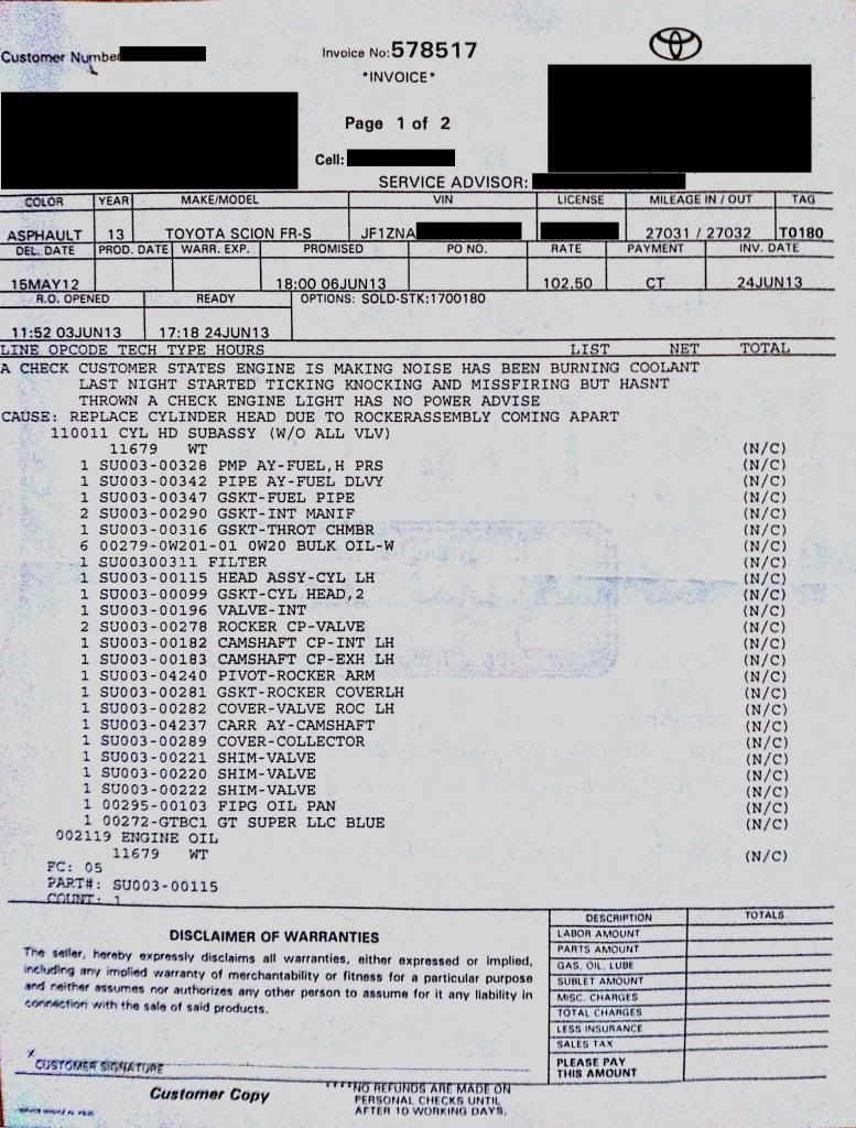

Long overdue parts list:
110011 CYL HD SUBASSY (W/O ALL VLV)
1 SU003-00328 PMP AY-FUEL, H PRS
1 SU003-00342 PIPE AY-FUEL DLVY
1 SU003-00347 GSKT-FUEL PIPE
2 SU003-00290 GSKT-INT MANIF
1 SU003-00316 GSKT-THROT CHMBR
6 00279-0W201-01 OW20 BULK OIL-W
1 SU003-00311 FILTER
1 SU003-00115 HEAD ASSY-CYL LH
1 SU003-00099 GSKT-CYL HEAD, 2
1 SU003-00196 VALVE-INT
2 SU003-00278 ROCKER CP-VALVE
1 SU003-00182 CAMSHAFT CP-INT LH
1 SU003-00182 CAMSHAFT CP-EXH LH
1 SU003-04240 PIVOT-ROCKER ARM
1 SU003-00281 GSKT-ROCKER COVERLH
1 SU003-00282 COVER-VALVE ROC LH
1 SU003-04237 CARR AY-CAMSHAFT
1 SU003-00289 COVER-COLLECTOR
1 SU003-00221 SHIM-VALVE
1 SU003-00220 SHIM-VALVE
1 SU003-00222 SHIM-VALVE
1 00295-00103 FIPG OIL PAN
1 00272-GTBC1 GT SUPER LLC BLUE
002449 ENGINE OIL 11679 WT
The car feels great. One thing that I noticed though - below 4k rpms the car felt very sluggish. It had a very on/off feel to the powerband. I say felt because I figured out what the issue was yesterday. They replaced the little cover that goes on the intake manifold. The problem was that I had trimmed the cover for the vacuum line running to the AOS. The line was pinched due to the cover. Fifteen minutes of trimming/filing and its back to the way it was, and the car feels peppier below 4k now.
That can't be cheap. Can anyone run the numbers on the parts used in the repair of @civicdrivr's vehicle? I've often wondered what a new head would cost...
